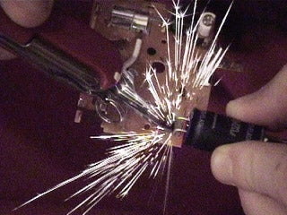

In particular situations, electricity itself can pose a threat. Shorts can generate large amount of heat with even small power sources, while higher voltages can deliver painful and even deadly shocks. The first step to mitigate these risks is to remove power sources, everything ranging from coin batteries to connections to a wall socket. Hopefully the later of the two was obvious. Unfortunately, certain components can retain energy from their last exposure to electrical energy, extending the threat. The most common culprit is the capacitor. Luckily, they can often discharge into the surrounding circuit in a matter of minutes. As such, I advise at least ten minutes between the last connection to power and the start of disassembly, especially in devices that can be connected to mains voltage. If at any time you find a particularly beefy capacitor which you suspect may still hold a charge, a good course of action is to deliberately short the capacitor with screwdriver with insulating handle. If all goes well, any remaining charge will be dispelled. If you don't feel conformable doing this, you may want to reconsider your disassembly project. And as a reminder, I take no responsibility for your mistakes should you attempt to follow my instructions. Regardless, we can finally go onto the less extreme part of safety.

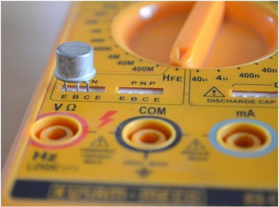

Though I could finish off with the last step, it is worth mentioning that it is good to get into the habit of organizing and testing parts. If your device was destined for the garbage can, you may have to worry about damaged components. Additionally, there are components such as electrolytic capacitors that can simply prove inoperable due to time. In either case, a quick test can prevent the woeful possibility that you use faulty components in your future projects. Tests vary, but in most cases a multimeter can do the job. In fact, some even have special transistor tester, such as in the first picture.
If a multimeter can't do the job, then a quick google search should be able to unearth some way to test any device in question. After testing the extracted components, it is then time to stow away your goodies for later use. This can pose a slight challenge as the extracted components are not necessarily any standard hobbyist model. Admittedly, I am currently between organization systems now and am currently storing most of my stuff in a single bin, though I intend to populate a set of miniature drawers at some point. Some of those parts and the drawer can be seen in the second image.
