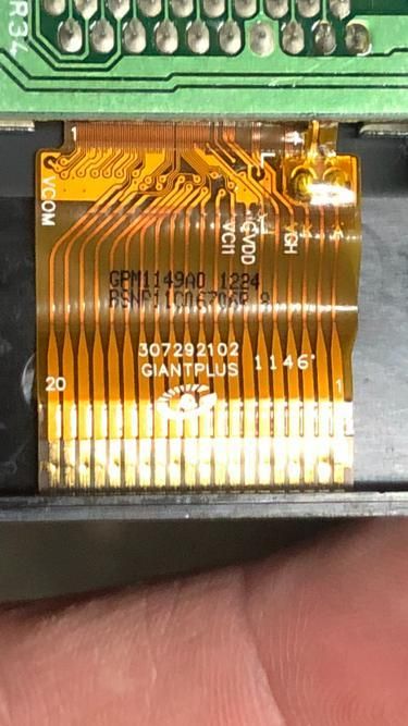

Step 3: Chip on Glass Liquid Crystal Displays (COG LCD)
Chip on Glass (COG) LCDs have the driver IC on the glass near the input pins or ribbon
connector (The rectangle on the glass near the pins & ribbon) and they come
in serial data input as well as parallel data input like TN, STN, and FSTN
modules. Many of the serial data input COG LCDs have the same number of pins as
the parallel data input LCDs, so with COG LCDs the datasheets are more
important as the inputs purpose is not easy to see when you are just looking at
the LCD.

Step 4: Salvaging COG LCDs
This printer display is parallel data input to the circuit board and parallel data input to the COG LCD, I know this by reverse engineering the circuit board and checking the components datasheets.

Step 10: Salvaging Other LCDs
This graphic LCD has everything needed to reuse it in a project.
It just unplugged from the rest of the electronics.
The driver is on the circuit board.
And the hookup is function labeled.
However not all LCDs are this easy to salvage.
