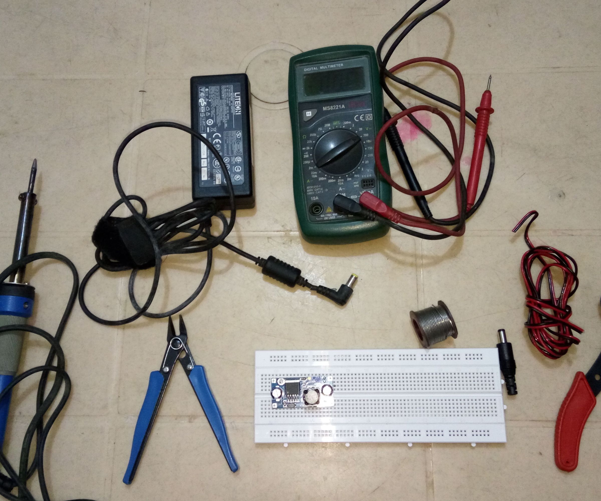

This is a pretty simple task. The webcam module I had 5 wires coming out of the module. Just follow the circuit connection drawing in the images section.
Dont forget to use 2 1N4001 Diodes in series just as shown in the drawing. I tried without these diodes initially and the system showed as "USB Unrecognized" error. And don't ask me why I used the diodes as even I just followed what was shown in the drawing :P
For USB extension I used a mobile USB charger cable, stripped of the micro USB connector from the wire and exposed all 4 wires. Carefully strip the wires and solder them to the appropriate wires and insulate them so that no 2 wires get short.
Once the soldering is done I just used a black insulation tape to put all wire together. I am still planning on making a casing for the circuit board along with some clips to attach.
