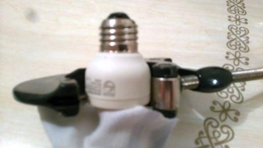

Step 2: Cut Along Seam With Large Tubing Cutter
Get a tubing cutter that cuts at least 2 1/2 copper tubing. Wrap a cloth or paper towel around glass part of bulb and cut the seam in white plastic part of base using back and forth motion to completely seperate top and bottom of bulb.
