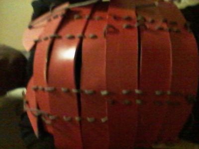

Step 4: The Torso
What You Need:
- Boxcutter Knife
- Sintra or Sintra-like Material
- 550 Paracord
- Heat Gun
- Spray Paint
- Lighter or Candle
- Drill with 11/64 Drill Bit
Instructions by Section
Shoulders:
Cut 2 rectangles that are 10 inches long and 2.5 inches wide. Drill in the middle at each end of the rectangle. Afterwards, use the heat gun and fit the rectangles right next to your neck. This section will be used to hold up the entire set of armor. Once you have fit the armor to your body, let it cool down and spray paint. The Paracord from the back armor will go through the holes drilled in the shoulder part.
Back:
Measure from one side of your stomach behind your back to the other side. Once you have this measurement, measure the length from your lower back to your armpits. Afterwards, divide the measurements equally and cut 5 pieces that are equal in length and width. Drill 4 columns of holes in the Sintra. The outer 2 columns should be about 2 inches from the closes edge. The inner 2 should be about 8 inches from the closest edge. Also, you should drill one hole each at the bottom rectangle. This hole will be used to connect the chest piece to the back piece. Once you have cut and drilled, heat up the rectangles. Fit the rectangles to your body and make sure to bend the ends so that the connection point will be easy to find. Heat up the paracord and connect the rectangles using the paracord. Make sure to layer the armor so that 1 out of 4 holes will be covered up by the hole of another rectangle. Spray paint, and then weave the armor together. Once you have done all of that, connect the remaining paracord from the middle holes to the shoulders. Have the paracord go through both holes of the shoulders. Cut another piece of paracord and set that aside as you will use it to connect the front and back pieces together.
Chest:
Measure from one side of your stomach across your stomach to the other side of your stomach. Measure from your waist to the top of your stomach. Cut 3 rectangles that divide this area equally and cut another three pieces that lose 2 inches in length for each piece. This will result in a large rectangle area that will protect your stomach and a blocky pyramid of sorts that will protect your chest. Once you have cut the rectangles, the 3 largest ones will be drilled. There will be four double columns. The outer columns will be about an inch away from the edges and the inner columns will be about 6 inches from the closest edge. Stack the rectangles that are different in length and drill through all of them at once. Make sure to align the inner 2 columns of the chest area with the inner 2 of the stomach. Heat up all the parts and fit them to the respective areas they will go to. Make sure to bend at the ends of the stomach section to easily connect the back with the stomach. While you are waiting for them to cool down, cut 2 trapezoids and align them with the top holes of the chest armor. Drill holes that will match the chest armor and drill one hole at the center top. This part will connect to the shoulder straps to hold the armor. Spray paint the armor and weave it all together.
