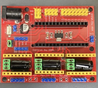

Step 2: CNC Shield V4 Clone Fix!
On online platforms there are various cloned CNC Shields for the Arduino NANO.
They are cheap and of good value but if you want to set Micro Stepping as they are, you can't.
Whoever made this shield made a mistake and put the pins that should go to Vcc to GND.
As the pins that set the Micro Step Mode are already pulled down to GND internally as default, and to change their state, they need pulling up to Vcc.
Watch this video tutorial to fix this error.
