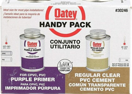

Pvc primer and cement - https://amzn.to/2W48tcx

Step 4: Let's Get Primed and Gluing
There is no real reason to start with one piece over another but below is way I performed this.
Always clean, prime then glue each piece. Let it dry before trying to manipulate it (this is pretty fast so you can just work on another section as you wait for another section to dry).
I started with the male adaptor being attached to the longest up and down section.
I then attached the small pvc section to the bottom of the Tee.
I then added the female connection to the bottom of the small piece now coming off the bottom of the Tee.
I then connected both side of the top of the tee.
