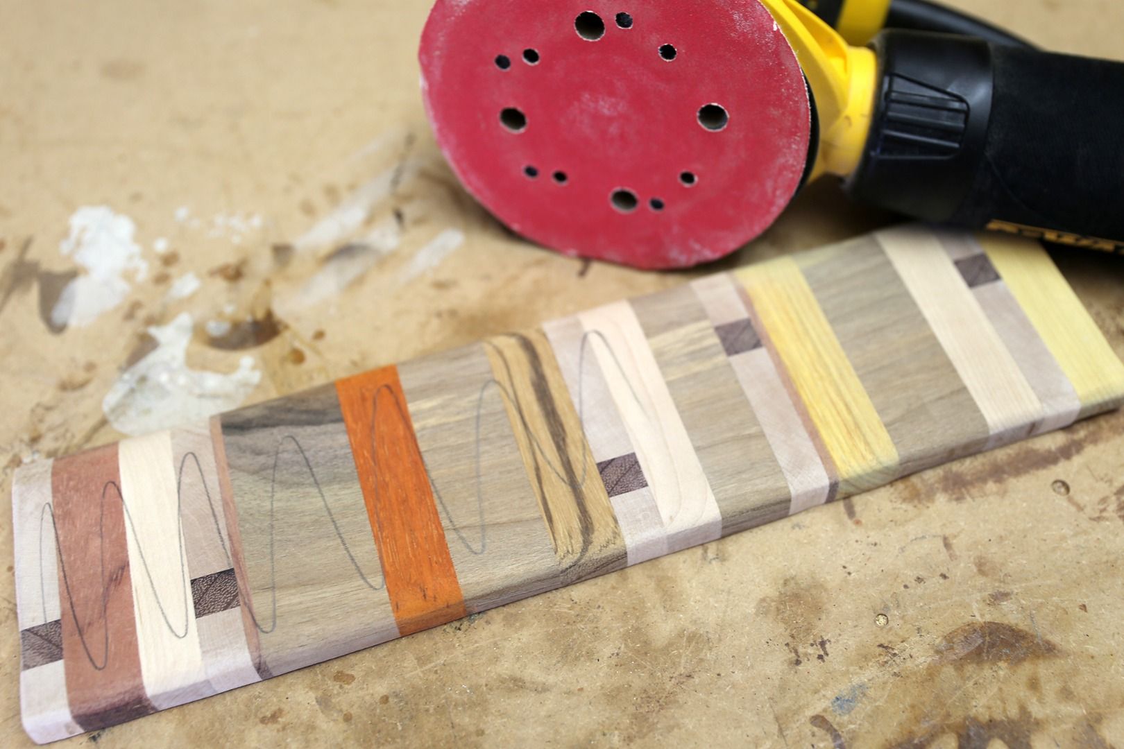

With coarse grits it's easy to see what area has been sanded, but this gets harder to notice as you step up to the higher grits. A great trick to help you visually is to scribble a pencil over the area you're working before you start sanding, as you start sanding you'll be removing a small amount of wood and removing the pencil marks.
Keep applying pencil to your work piece as you step up the grits to keep track of where you've sanded and what spots need more attention.
Step 4: Working With Mixed Densities
Wood comes in all kinds of densities and each of these densities sand down differently. When working with mixed wood types be mindful that less dense woods will abrade faster than denser woods.
In the picture sown here there's an example of two woods that sanded at different amounts on the left side near the bottom.
