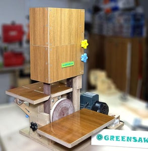

Hello, this is my first post here. I made a Sanding Machine, which is a combined belt and disc sander. You can find the details below, you can also watch my Youtube video. You can download the PDF document from my site.

I'm starting to make the first piece that will form the body. I use 18mm hard plywood. I glue 2 of them together and cut them.
Step 3:
I cut 6 discs of 182mm in diameter from lightweight plywood. I glue them together in the form of 3 + 3.
Step 4:
After refitting the bearings. I glue the parts and fix them with screws to form the main body. After fixing the engine, I put on the belt. Now I can energize the engine.
Step 5:
I do some turning and sanding to balance the main wheel. I make sure it is stable and vibration free.
Step 6:
It's time for the top wheel. I fix the M8 metals in place and sand the ends. I open the bearing housings for the upper wheel. After installing the bearings, I snap the upper wheel into place. After attaching the 50x1500mm sanding belt, I start the motor and do some sanding. I make sure the upper wheel is balanced. I give the proper shape by sanding the sides a little too much.
Step 7:
I attach a 180mm diameter velcro to the lower wheel. I will attach sandpaper to this. I assemble the flat table for disc sanding in place
Step 8:
For the belt sanding section, I also fix the thick metal in place. I fix the adjustable angle table in place.
Step 9:
I set the trays at 90 degrees and do the first sanding. Here is the test video.
