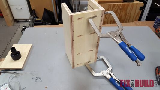

Step 2: Assemble the Rack
Using 1-1/4" pocket hole screws assemble the rack. Using right angle clamps really helps here.
