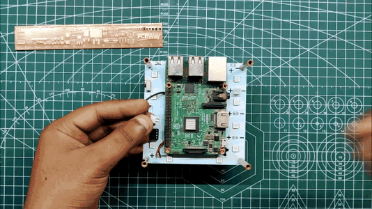

So I made this simple system that consists of three layers, each made from FR4 PCB. The first layer, or battery layer, contains a power management IC (IP5306) with four Li-ion cells that give a stable 5V output for running the Pi and other stuff.
The second layer holds the Raspberry Pi in place by using the four mounting holes present on the Pi. I used PCB standoffs to hold the Pi in place.
It also has RGB LEDs (WS2812B) to make this setup look cool and hip; they are powered by the onboard Attiny85 MCU, and the color is controlled by a vertical push-button.
The third layer contains a cooling fan setup; a DC 5V fan is placed right on top of the Raspberry Pi processor and is powered by a proper fan driver made by using a Mosfet IC controlled by an Attiny13A; this concept was reused from one of my previous projects.

The second layer is the carrier board, which contains two main parts, the connector array that distributes power from the input side to all connectors and the Attiny85 setup that is connected with 10 WS2812B LEDs.

Step 6: Raspberry Pi Carrier Layer Assembly
Let's start the Raspberry Pi Carrier Board Assembly.
  • Like the previous board, we first need to add solder paste to each component pad one by one by using a solder paste dispensing syringe.
  • We then pick and place all the SMD components in their assigned places one by one
  • Next, we carefully lift the whole circuit board and place it on a Reflow Hotplate.
  • We then add THT Components which are the vertical Button, JST connector, slide switch, and DIP8 IC Socket.

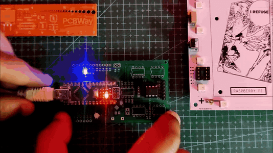

Step 7: Attiny85 Programming
As for the programming process, we cannot directly program the ATTINY85 through a USB. There's a method for programming the Attiny straight from the USB port, but I'm not doing that.
Instead, I'll be using the ISP flashing method, which will utilize the SPI pins of the ATtiny85 to burn the bootloader into it and then upload the main sketch into it.

AVR chips are typically shipped blank; they must be configured to be Arduino IDE compatible, which requires the use of an AVR programmer, such as a USBASP.
Fun fact: you could make your own AVR programmer with an Arduino Uno or a Nano board in a very easy step.
  • Connect your Arduino board with the com port and select the following sketch
  • Example>ArduinoISP upload this sketch onto your board
  • After uploading, go to the tools menu and choose the Arduino as ISP option in the programmer section.
  • Now for flashing Attiny85, we can select Attiny85 in the Board section.
The programming process uses VCC, GND, and four data pins. Three pins connect MISO, MOSI, and SCK between the programming microcontroller and the target. The fourth pin from the programming microcontroller goes to the reset pin of the target device.
Instead of using an Arduino UNO and a breadboard for this job, I will use my DIY Attiny Programmer, which I made for flashing the Attiny or Atmega MCUs.
which you can check out from here- https://www.instructables.com/Multiple-ATtiny8513A-Programmer/
  • connect the Board to the Arduino as ISP Setup in the above wiring config
  • choose the right port, and right programmer (Arduino as ISP), and hit Burn Bootloader
  • wait for few seconds, you will get done burning the bootloader message.
  • Now Open the sketch that you want to upload to this Attiny
  • Go to the Sketch menu and select Upload using the programmer.
  • and your Sketch will get uploaded onto the attiny85.

Step 8: Adding Raspberry Pi to the Carrier Board
  • Next, we mount the Raspberry Pi to the carrier board by using eight PCB standoffs and four mounting screws.
  • Eight standoffs are added to the Raspberry Pi's four mounting holes.
  • Later, four screws are used to hold the Raspberry Pi to the carrier board.
  • The Carrier board is now completed.

Step 11: Fan Layer Code and Programming
The fan layer is driven by the Attiny13A, which is programmed by connecting the same Arduino Nano-based ISP device that I used to program the Attiny85.
We need to download the Attiny13 cores first, which are not included in the Attiny85 core.
  • Open the File > Preferences menu item.
  • Enter the following URL in Additional Boards Manager URLs: https://mcudude.github.io/MicroCore/package_MCUdude_MicroCore_index.json
  • Open the Tools > Board > Boards Manager... menu item.
  • Wait for the platform indexes to finish downloading.
  • Scroll down until you see the MicroCore entry and click on it.
  • Click Install.
  • After installation is complete close the Boards Manager window.
