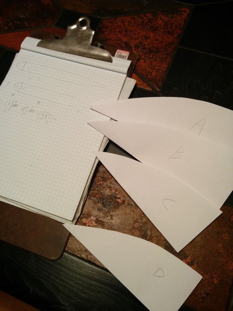

When I got home, I measured some other body pillows around the house for comparison. I decided I wanted a diameter of about 8 inches, and a length of as close to 2 yards as I could get. The overall shape would be simple: a long tube, made up of 3 pieces. (Labelled "A" in the diagram.) These had a single jaw "petal" at one end, and a gradual taper at the other end for the tail. Inside the jaw section was a matching bit, B, in the outer mouth fabric, slightly smaller to give an arc when stuffed. Inside this was the inner mouth jaw, again in two pieces C and D. The inner part of the inner jaw, D, had an extension to form a throat.
Feel free to print out my pattern if you have a large format printer that can handle it, but it's not that hard to draft from scratch. To make the curved parts of the jaws for the pattern, I measured out the width and half the height on a piece of paper, sketched the curve in freehand, then folded the paper over and cut it out. I then used these templates to trace the shapes in pencil on the backside of the fabric before cutting. For the pieces with straight edges, I drew those directly on the fabric with a ruler.
