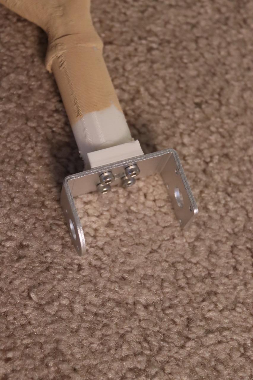

Step 11:
A special bracket was designed and 3d printed to mate the hand/arm to the motor mechanism.
