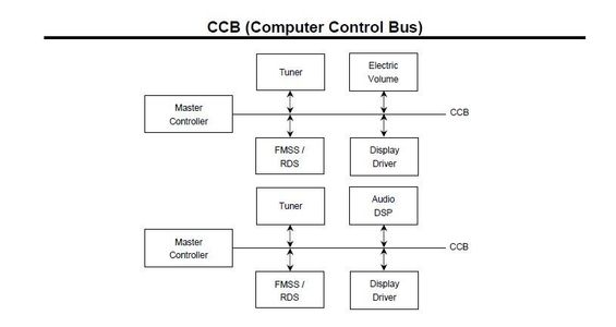

What is Sanyo (CCB)?
This Computer Control Bus (CCB) is a bus format that is designed to ensure that communication in a system configured
with a multiple number of ICs is achieved reliably and economically. It is designed for communication between ICs in
equipment and not for communication between products requiring long lines.
The CCB is a single master system, which obviates the need for complex arbitration processing. This reduces the hardware
load significantly, enabling the construction of extremely economical systems. Furthermore, many and varied groups of
devices including tuners, electronic volumes, digital signal processors for audio applications, and display drivers are
provided to support a broad spectrum of needs. Using software or serial I/O facilities, the CCB can easily interface with
many different kinds of controllers so that no special hardware is required.

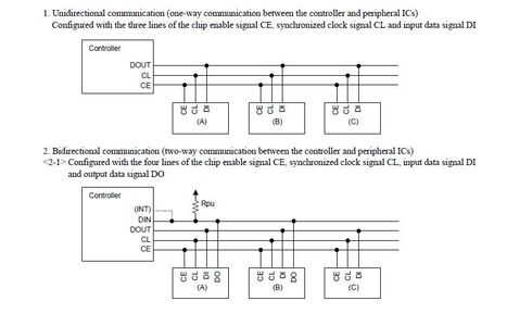

Configuration of Serial Data Communication
CCB format-based communication between the controller and the peripheral ICs can be achieved in two ways:
unidirectional communication (one-way communication between the controller and peripheral ICs) or bidirectional
communication (two-way communication between the controller and peripheral ICs and two-way communication
between the peripheral ICs).

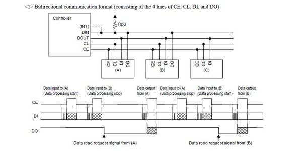

Unidirectional communication is configured with the three lines of the chip enabling signal CE, synchronized clock signal
CL and input data signal DI, whereas bidirectional communication is configured with the four lines of the chip enable
signal CE, synchronized clock signal CL, input data signal DI, and output data signal DO. In recent years, ICs with a

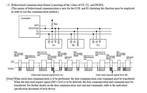

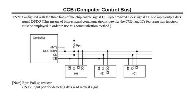

new means of bidirectional communication, consisting of the three lines of the chip enable signal CE, synchronized
clock signal CL and input/output data signal DI/DO, have also been developed.

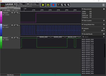

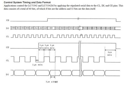

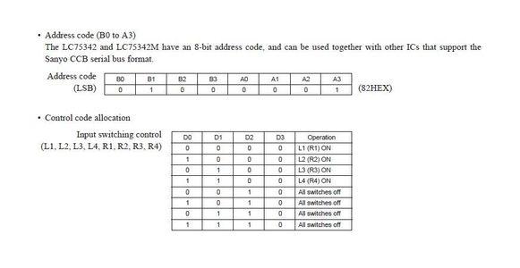

Serial Data Communication Format

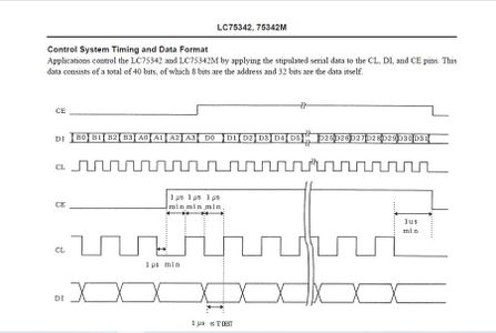

Under the CCB format, when data is to be sent from the controller to the peripheral ICs, it is sent by the following series
of operations. The controller transfers the CCB addresses B0 to B3 and A0 to A3 while the chip enable signal CE is low.
After all the addresses have been transferred, the CE signal level is switched from low to high, and while this signal is
high, the data DI0 to DIn (input data) required by the peripheral ICs is transferred. The CE signal level is then switched
from high to low. In addition, the CCB addresses and input data to be sent from the controller are imported into the
peripheral ICs by the rising edge of the CL signal.
On the other hand, when data is to be received by the controller from the peripheral ICs, it is received by the following
series of operations. The controller transfers the CCB addresses B0 to B3 and A0 to A3 while the chip enable signal CE
is low. After all the addresses have been transferred, the CE signal level is switched from low to high, and while this
signal is high, the data DO0 to DOm (output data) is read from the peripheral ICs. CE signal level is then switched from
high to low. In addition, since the CCB addresses to be sent from the controller are imported into the peripheral ICs by
the rising edge of the CL signal, and the output data to be received by the controller is output from the peripheral ICs in
synchronization with the falling edge of the CL signal, the controller can import the output data DO0 to DOm at the

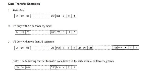

As a basic rule, the CCB addresses have a bit width of 8 bits, and the data has a bit width that is a multiple of 8 (8 a
bit width where "a" is a natural number). However, there are 4-bit CCB address groups among the CCB address groups
so, in this case, dummy data must be added to the CCB addresses B0 to B3.

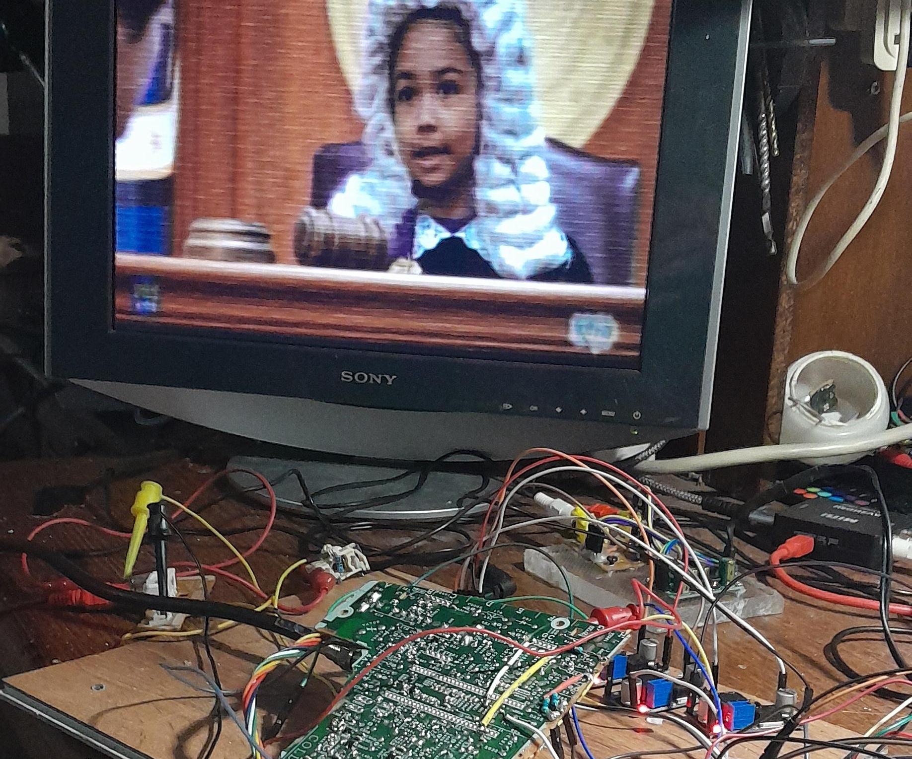

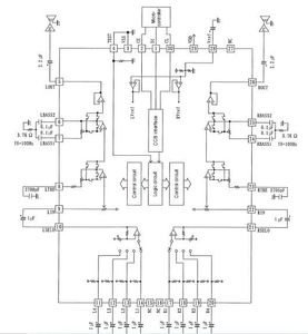

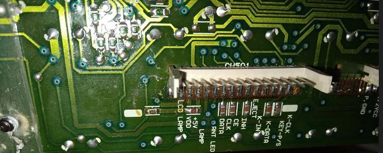

  1. I did pull off the LCD display board from Volvo car (1998)
  2. Sanyo radio tuner from an old cassette

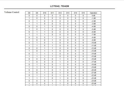

  3. Sanyo Single-Chip Volume and Tone Control System IC from an old cassette
  4. I did cut of an audio amplifier board with speaker from an old LCD TV
  5. Remote control IR receiver board from an old plasma TV
  6. Samsung remote control
  7. Arduino Nano
  8. old desktop power supply

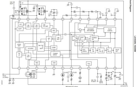

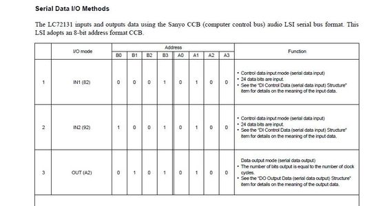

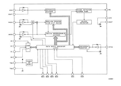

Step 1: Sanyo LC72131 AM/FM PLL Frequency Synthesizer
.It is very good practice to program different Phase-Locked Loop (PLL) like radio or TV tuner new or old technology, It will help you understand how Frequency demodulation work, I did program three different TV tuner and three different Radio tuner, there is a lot of similarity in (PLL) but different technique.
For communication to work, both the sender and the receiver must agree on what communication channel to use. After which, the sender encodes the message and transmits it to the receiver. Then, the receiver receives the message and decodes it. This holds true to FM: the transmitted FM signal is received and must be demodulated to take the information. This is what FM detectors do.
.What is Frequency Demodulation?
FM demodulation is a key process in the reception of a frequency modulated signal. Once the signal has been received, filtered and amplified, it is necessary to recover the original modulation from the carrier. It is this process that is called demodulation or detection.
There are different types of FM demodulators including:
  1. Slope Detector
  2. Foster-Seeley Discriminator
  3. Ratio Detector
  4. Pulse-Averaging Discriminators
  5. Quadrature Detectors
  6. Phase-Locked Loops

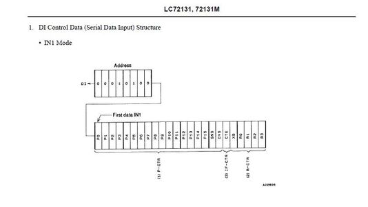

.In this project id did use Sanyo LC72131 AM/FM PLL Frequency Synthesizer.

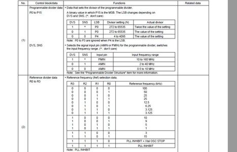

Functions
• High speed programmable dividers
— FMIN: 10 to 160 MHz ..........pulse swallower
(built-in divide-by-two prescaler)
— AMIN: 2 to 40 MHz ..............pulse swallower
0.5 to 10 MHz ...........direct division
• IF counter
— IFIN: 0.4 to 12 MHz ...........AM/FM IF counter
• Reference frequencies
— Twelve selectable frequencies
(4.5 or 7.2 MHz crystal)
1, 3, 5, 9, 10, 3.125, 6.25, 12.5, 15, 25, 50 and 100 kHz
• Phase comparator
— Dead zone control
— Unlock detection circuit
— Deadlock clear circuit
• Built-in MOS transistor for forming an active low-pass
filter
• I/O ports
— Dedicated output ports: 4
— Input or output ports: 2
— Support clock time base output
• Serial data I/O
— Support CCB format communication with the
system controller.
• Operating ranges
— Supply voltage........................4.5 to 5.5 V
— Operating temperature............–40 to +85°C

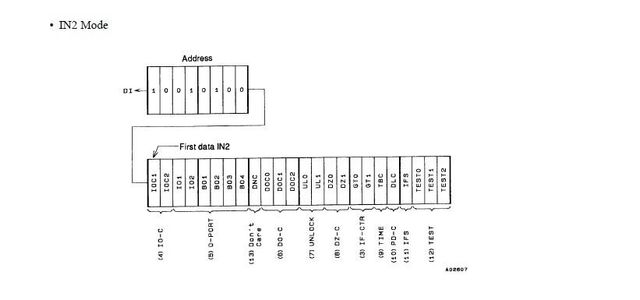

Programmable Divider Calculation Examples
• FM, 50 kHz steps (DVS = 1, SNS = *, FMIN selected)
FM RF = 90.0 MHz (IF = +10.7 MHz)
FM VCO = 100.7 MHz
PLL fref = 25 kHz (R0 to R1 = 1, R2 to R3 = 0)
100.7 MHz (FM VCO) ¸ 25 kHz (fref) ¸ 2 (FMIN: divide-by-two prescaler) = 2014 > 07DE (HEX)

// LC72131 IN1, byte 2
#define IN10_R3     7
#define IN10_R2     6
#define IN10_R1     5
#define IN10_R0     4
#define IN10_XS     3
#define IN10_CTE    2
#define IN10_DVS    1
#define IN10_SNS    0

        bitWrite(pll_in2[0],  IN20_GT0   , 0);
        bitWrite(pll_in2[0],  IN20_GT1   , 1);//////////
        bitWrite(pll_in2[0],  IN20_TBC   , 0);
        bitWrite(pll_in2[0],  IN20_DLC   , 0);
        bitWrite(pll_in2[0],   IN20_IFS   , 0);
        bitWrite(pll_in2[0],  IN20_TEST0  , 0);
        bitWrite(pll_in2[0],  IN20_TEST1  , 0);
       bitWrite(pll_in2[0],  IN20_TEST2  , 0);
      break;
    case LC72131_BAND_AM:
      band = LC72131_BAND_AM;
     bitWrite(pll_in1[0], IN10_SNS , 1); //
      bitWrite(pll_in1[0], IN10_DVS, 0); //
      bitWrite(pll_in1[0], IN10_CTE , 0); //
      bitWrite(pll_in1[0], IN10_XS, 0); //
      bitWrite(pll_in1[0], IN10_R0,  0); //
      bitWrite(pll_in1[0], IN10_R1,  0); //
      bitWrite(pll_in1[0], IN10_R2,  0); //
      bitWrite(pll_in1[0], IN10_R3,  1); //
        bitWrite(pll_in2[2], IN22_IOC1, 1);
        bitWrite(pll_in2[2], IN22_IOC2, 1);
        bitWrite(pll_in2[2], IN22_IO1, 1);
        bitWrite(pll_in2[2], IN22_IO2, 0); //
        bitWrite(pll_in2[2], IN22_BO1, 1); //
        bitWrite(pll_in2[2], IN22_BO2, 0); //
        bitWrite(pll_in2[2], IN22_BO3, 0); //
       bitWrite(pll_in2[2], IN22_BO4, 0);
        bitWrite(pll_in2[1], IN21_DNC , 1); //
        bitWrite(pll_in2[1], IN21_DOC0 , 1); //
        bitWrite(pll_in2[1], IN21_DOC1 , 0); //
        bitWrite(pll_in2[1],  IN21_DOC2, 0); //
        bitWrite(pll_in2[1], IN21_UL0 , 0);
       bitWrite(pll_in2[1], IN21_UL1 , 0);
       bitWrite(pll_in2[1], IN21_DZ0  , 0);
       bitWrite(pll_in2[1], IN21_DZ1 , 1);
        bitWrite(pll_in2[0],  IN20_GT0   , 1);
        bitWrite(pll_in2[0],  IN20_GT1   , 0);
      break;
  Radioccb.write(B10000010, pll_in1, 3 );
  Radioccb.write(B10010010, pll_in2, 3);
                        LC72131Tune()
  Set the tuner frequency and return 1 if it is tuned
  or 0 otherwise.
  The frequency divisors was chosen in a way the frequency
  representation can be directly sent to the PLL and is
  easy to represent:
   FM mode (divisor = 100): frequency (MHz) * 10
   AM mode (divisor = 10):  frequency (kHZ) / 10
uint8_t LC72131Tune(uint16_t frequency) {
  uint16_t fpd = 0;
 // unsigned long IFCounter = 0;
  switch(band) {
    case LC72131_BAND_FM:
      // FM: fpd = (frequency + FI) / (50 * 2)
      fpd = (frequency + 107);
      break;
      // AM: fpd = ((frequency + FI) / 10) << 4
      fpd = (frequency + 45) << 4;
      break;
    default: return 1;
  LC72131SetMode(LC72131_MUTE);   // LC72131 only injects FI signal into the PLL when in MUTE mode
  // Reset the IF counter and program the Frequency Programmable Divider (fpd)
  bitClear(pll_in1[0], IN10_CTE);
  pll_in1[1] = byte(fpd >> 8);
  pll_in1[2] = byte(fpd & 0x00ff);
  // Start the IF counter
  bitSet(pll_in1[0], IN10_CTE);
LC72131SetMode(LC72131_UNMUTE);   // Mute off / normal tuner mode
  return 0;
.and I did use Sanyo LA1833N System-on-Chip Tuner IC for Home Stereo Systems.
Functions
• AM: RF amplifier, mixer, oscillator, IF amplifier,
detector, AGC, SD, oscillator buffer, IF buffer, and
stereo IF output
• FM IF: IF amplifier, quadrature detector, S meter, SD,
S-curve detector, IF buffer
• MPX: PLL stereo decoder, stereo indicator, forced
mono, VCO stop, audio muting, adjacent channel
interference reduction function, pilot canceller

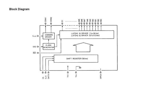

Step 2: Sanyo LC75821E LCD Display Drivers
.This display is (TN) LCD
twisted nematic (TN) display is a common type of liquid-crystal display ( LCD ) that consists of a substance called a nematic liquid crystal that is confined between two plates of polarized glass
.In my case this display has 3 Digits 7 Segments and small digit 7 segments and one digit 9 segments and 8 static icons
For the Sanyo LC75821E LCD Display Drivers:
The LC75821E and LC75821W are general-purpose LCD
display drivers that can be used for frequency display in
microprocessor-controlled radio receivers and other
display applications.
Features
• 53 segment outputs (the maximum for static drive)
• Two drive types: static (1/1) duty (53 segments) and 1/2
duty (104 segments)
• Data input: 3 serial input pins
• INH pin for turning off all display output

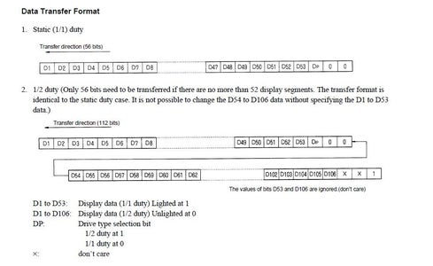

.First I practiced sending data over the Sanyo CCB Bus according to the data sheet of the Sanyo LC75821E LCD Display Drivers, to know which bit controls which segments and icons.
.So for this display it is a type of Static (1/1)duty
Transfer direction (56 bits)
<----------------------------- D1 D2 D3 ..................................D47 D48 D49 D50 D51 D52 D53 D0 0 0.
. I have to use bitwrite() Function to select which bit to be 0 or 1, that is a lot of work because the Sanyo LC75821E LCD Display Drivers need 56 bits to drive the display.
For example, to display number one in the first digit from the left of the display it will be

the digit number one from the left is from bit number 17 to bit number 25, and for digit number two it is from bit number 26 to bit number 34. and so on for the rest of the display.
Step 3: Sanyo LC75342 Single-Chip Volume and Tone Control System
The LC75342 and LC75342M are electronic volumes and
tone control systems that provide volume, balance, a 2-
band equalizer, and input-switching functions that can be
controlled from serially transferred data.
Functions
• Volume: 0 dB to –79 dB (in 1-dB steps) and –°, for a
total of 81 settings.
The volume can be controlled independently in the left
and the right channels to implement a balance function.
• Bass boost: Up to +20 dB in 2-dB steps. Peaking
characteristics.
• Treble: ±10 dB in 2-dB steps. Shelving characteristics.
• Selector: One of four sets of left/right inputs can be
selected.

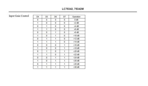

• Input gain: The input signal can be boosted by from
0 dB to +30 dB in 2-dB steps.
Features
• On-chip buffer amplifiers minimize the number of
external components.
• Fabricated in a silicon gate CMOS process to minimize
switching noise from internal switches.
• Built-in analog ground reference voltage generation
circuit.
• All controls can be set from serially transferred data.
Supports the CCB standard.
Control System Timing and Data Format
Applications control the LC75342 and LC75342M by applying the stipulated serial data to the CL, DI, and CE pins. This
data consists of a total of 40 bits, of which 8 bits are the address and 32 bits are the data itself.
for example (Control code allocation) from bit 0 to bit 7 is the IC address and from bit 8 to bit 11 is to select the input switching control, to select like AUX input that connects to bit number 8 =1, and for input gain control from bit number 12 to bit number 15, and for volume control from bit number 13 to bit number 21, and so on for the rest of the function of the IC.

void InputGainControl(byte data){
  bitWrite(SignalChipControl[3], LC75_IG1, bitRead(data,3));
  bitWrite(SignalChipControl[3], LC75_IG2, bitRead(data,2));
  bitWrite(SignalChipControl[3], LC75_IG3, bitRead(data,1));
  bitWrite(SignalChipControl[3], LC75_IG4, bitRead(data,0));

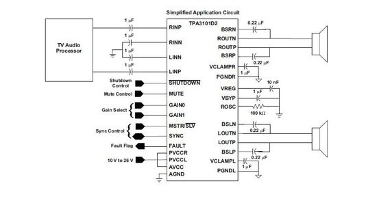

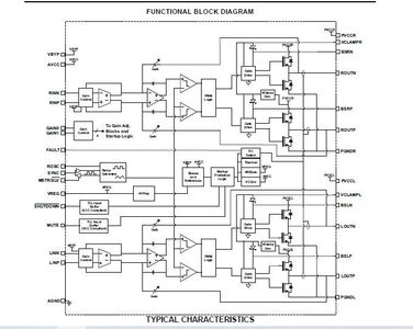

Step 4: TPA3101D2 10-W STEREO CLASS-D AUDIO POWER AMPLIFIER
.I did cut this board from an old LCD TV it is an Class-D audio power amplifier, I did read the data sheet first before I cut it from the TV to mark all the rea for the IC connection .
FEATURES
10-W/ch into an 8-Ω Load From a 13-V Supply • Televisions
• 9.2-W/ch into an 8-Ω Load From a 12-V Supply
DESCRIPTION • Operates from 10 V to 26 V
• 87% Efficient Class-D Operation Eliminates The TPA3101D2 is a 10-W (per channel) efficient,
Need for Heat Sinks Class-D audio power amplifier for driving bridged-tied
stereo speakers. The TPA3101D2 can drive stereo
• Four Selectable, Fixed Gain Settings speakers as low as 4 Ω. The high efficiency of the
• Differential Inputs TPA3101D2, 87%, eliminates the need for an
• Thermal and Short-Circuit Protection With external heat sink when playing music.
Auto Recovery Feature The gain of the amplifier is controlled by two gain
• Clock Output for Synchronization With select pins. The gain selections are 20, 26, 32,
Multiple Class-D Devices 36 dB.

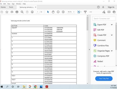

Step 5: Remote Control IR Reciver
First I used use IRremote library to decode each button in the remote control, and use that value for a specific function
#include <Arduino.h>
#include <IRremote.h
int RECV_PIN = 2; // IR Receiver pin
IRrecv irrecv(RECV_PIN);
decode_results results;
void setup() {
 // put your setup code here, to run once:
 irrecv.enableIRIn();
 Serial.begin(9600);
 Serial.println(results.value,DEC);
void loop() {
 // put your main code here, to run repeatedly:
 if (irrecv.decode(&results)){
   irrecv.resume();

   case 3772833823://volum UP
    vol++;
    InputSwitchingControl(1,vol);
    lcd.setCursor(0,0);
    lcd.print("VOL");
    lcd.setCursor(4,0);
    lcd.print(vol);
    Serial.println(vol);
     if(vol >= 80)vol=80;
    break;
    case 3772829743://Volum DOWN
   vol--;
    lcd.setCursor(0,0);
    lcd.print("VOL");
    lcd.setCursor(4,0);
    lcd.print(vol);
   if(vol <=0)vol=1;
   break;
