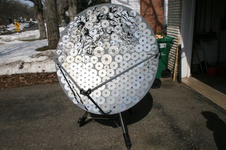

One of my favorite finds was a 4ft fiberglass satellite dish (reuse). I had built solar cookers as a child using cardboard and aluminum foil. I knew this dish was the correct shape for the task.

The surface of the dish is textured and curved. This means a straight layout in a hexagonal pattern would not work. Some size adjustments would be necessary. I was unsure what type of adhesion to use, but I knew I did not want to screw them on. If the glue was strong enough, hopefully the adhesion would warp the platters to increase the efficiency of the focus. So, I tried contact cement. It went ok, but did not hold as I anticipated. Next I tried RTV silicone (automotive), and it worked well.
Step 3: Complete Layout
The rest of the dish was done with standard white tub caulk. The hex pattern worked to some extent, and the areas where overlap or shortages occurred, I substituted different sized platters. Most of the platters are 3.5" from standard hard drives. A few are 3.25", some 2.5", and three 5.25" platters. Total on this dish is 149 hard drive platters. I also had to change the alignment to stay clear of the four mounting bolts in the center of the dish.

The time of year is March. There is still snow on the ground. But it was time to experiment. These are photos from its first setup in the sunlight. I first tried a wooden shim, which quickly ignited. I had a touch-free laser thermometer, but its upper limit was around 1000 degrees F. Look at the reading, there is no decimal point in there. Awesome!
