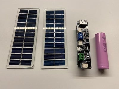

This build combines the two mini solar panels, a battery (needed for storage, and decent charging speed), and a circuit board, into a very usable sustainable power source in style.
It's easy to build, costs only about 20$ with all new parts, and will give you some free energy!
To buy:
  1. Solar panels: ~10$ (for 5)
    Sunyima 6V 1W 132*48Mm
    (other 5.5V or 6V rated solar panels will also work, but need a custom 3d printed holder)
  2. Any 18650 battery: ~6$ (with a minimum lower than 2.9V - and a maximum at 4.2V)
    For example Samsung cell
  3. Circuit Board: ~4$
    Circuit Board - Lilygo T-Bat for 18650 (CN3065 chip)

Step 2: Electrical: Soldering the Solar Panels
The first step is to solder wires to the solar panels.
The plus and minus are assigned with little stickers, color-code your wires for extra safety.
After soldering make sure to add a lot of tape, the connections should never be able to touch. I even added a small dot of hot glue to the end, this acts as a little strain relief for the brittle solder connections.
Afterwards, cut the wires to a length of about 7 cm (quite long, but this makes it easier to assemble).
Strip the end to about 5mm, this will is used for the connection to the board.
Step 3: Electrical: Connecting the Solar Panels
Now the solar panels can be connected to the board. Make sure to retest polarity first, otherwise the board can be damaged!
If the polarity is good for both panels, we can add them to the board. First open up the screw terminals by twisting them with the small screwdriver. Start by adding either both red "+" wires or both black "-" wires together in the solar input. After tightening the screw, make sure to pull on both wires so you can test if they are connected strongly.
Repeat this for the other two wires. Now your electrical circuit is almost done!
Step 4: Electrical: Inserting the Battery
Start again by testing the polarity of the battery. Add markings ( + and - ) right away. This makes sure you correctly remember the polarity.
Now for the easiest step, check the markings on the PCB of the board. (Always check the PCB, the holder also has markings but is sometimes placed on mirrored). Push the battery in, and you're done with the electrical part of the build!
