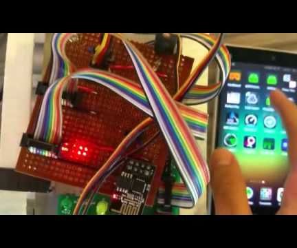

My OCD is a project where by i have an android application that can switch off the lights or the air condition from anywhere that has internet(practically anywhere thanks to the availability of data plans).

1.ESP-01(ESP8266)
2.Android phone
3.Servo(I'm using MG90)
4.USB to UART(I'm using CP2102)
5.3v3 power supply(I'm using ywrobot PSU)
CP2102 -- -- ESP-01 -- -- ywrobot PSU
RX -- -- TX
TX -- -- RX
-- -- VCC -- -- 3V3 (Do not use 3V3 from CP2102)
GND -- -- GND - CH_PD -- -- GND
RST connected to a push button at normal high. RST is active low meaning when set to Ground, it'll activate.
GPIO0 set to VCC for normal mode meaning it'll run the program that was uploaded and set to GND to run in Programming mode to upload a program. always reset when changing the GPIO0 to change the chip mode.
Sometimes the ESP-01 takes up too much power so i have attached a 220uF Capacitor to the power supply.
If using an external supply, always connect the GND of the external supply to all the GND of the working circuit. Always have a common ground.
The ywrobot board is supplied by a DC barrel plug. input voltage ranging around 6V-12V. Using the little connectors on the power rails to select which voltage output you want.(3V3 or 5V, use 3V3 in our case)
The Servo has 3 connections, VCC, GND and Control.
Servo -- -- ESP-01 -- -- ywrobot PSU
VCC -- -- -- -- 5V(use the second power rail or use an external 5V)
GND -- -- GND -- -- GND
Control -- -- GPIO2
