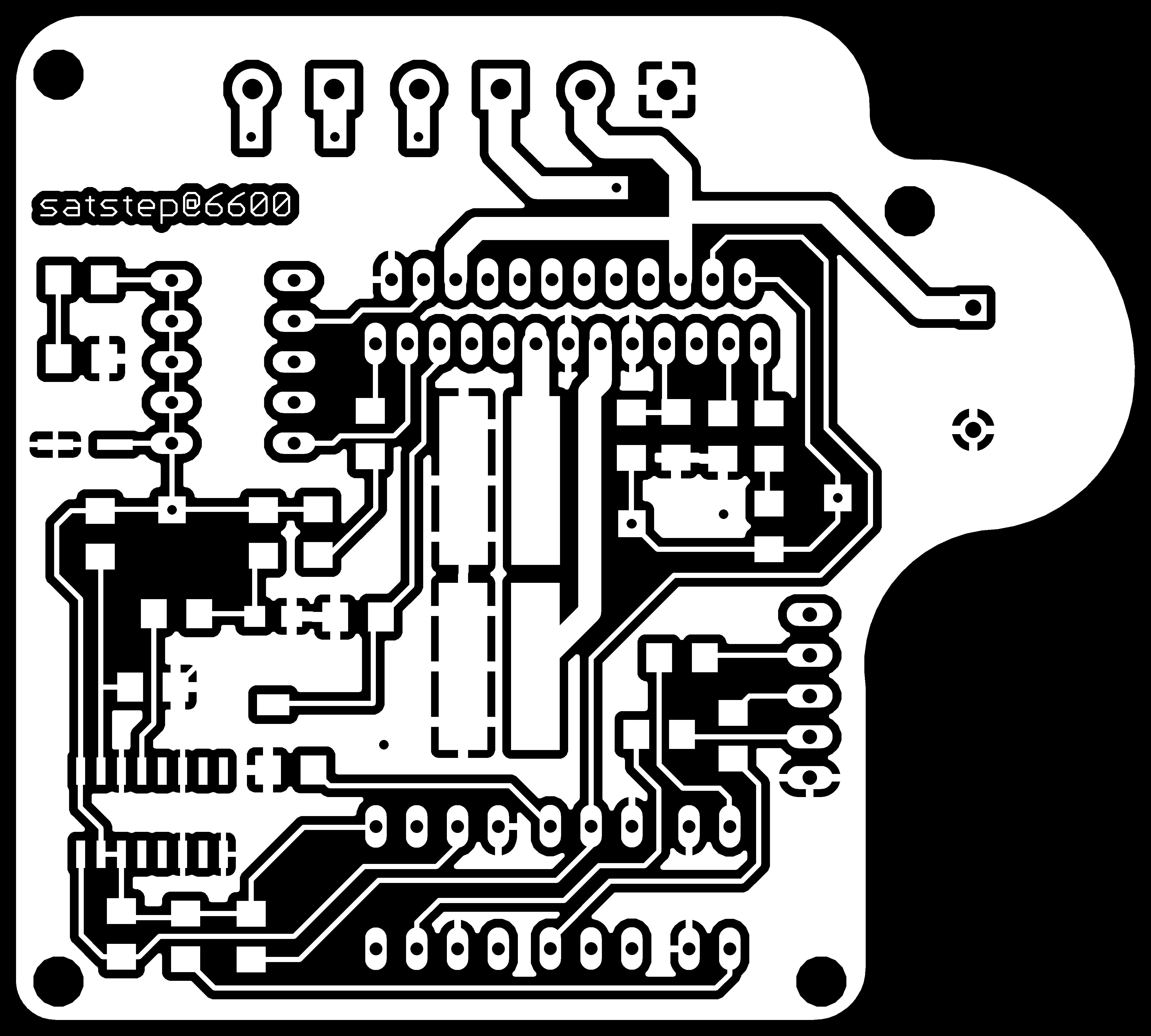

Once you have done the modifications you need, use the following steps to export a PNG image from Eagle (see attached pictures):
- Open the board layout
- Press the layer button
- Select only top and pads (also VIAs in case the PCB is dual layer like the satstep6600)
- Make sure that signal names will not be shown in the image by going to Set->Misc and uncheck
- signal names on pad
- signal names on traces
- display pad names
- Zoom the board design to fit the viewable screen
- Select File->Export->Image
- Set the following in the export Image pop-up window:
- check monochrome
- select Area->window
- type a resolution of at least 1500 DPI
- Select the file saving location (Browse)
- hit the ok button
After this you should have a black and white PNG (see attached picture). Repeat the process for the bottom layer in case you have a double sided board.

After you have the PNGs files, you are ready to generate the GCode for milling.
You have to do generate the GCode for each single PNG you have, traces.png , cutout.png and eventually the holes.png.
For the traces.png file those are the steps with the Fab Modules:
- go to http://fabmodules.org/
- open the traces.png file
- select your machine:
- gcodes will work for the GRBL based machines (usually also the small chinese cnc are based on it)
- Roland RML for Roland
- select process 1/64
- In case you selected the Roland RML, select your machine (SRM-20 or another etc..)
- edit the following settings:
- speed, I recommend 3mm/s with the 0.4mm and the 0.2mm chamfered tools, 2mm/s for the 0.1mm
- X0, Y0 and Z0, put all of them to 0
- cut depth can be 0.1mm with the cylindrical tools 0.4mm, 0mm with the chamfered ones
- tools diameter must be the one you have (if some traces are impossible to make, trick it by putting slightly less diameter of the one you have, until the traces will be shown after pressing calculate)
- press the calculate button
- wait for the path to be generated
- press the save button to save the Gcode
For the holes.png and the cutout.png the steps are the same, except:
- select process 1/32
- reduce the speed, I recommend 1-2mm/s
- check and put in (a little more than) the thickness of your PCB copper sheet
- check and put in the tool diameter for the cut out (usually 0.8 or 1mm)
Keep the files you saved with you as we are going to need them to make the PCB with the CNC milling machine.
