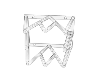

Parts needed for the Gantry:
- 1x GantryA
- 10x GantryB
- 1x GantryC
- 4x SupportArm
- 1x Crane
- 1x Hatch
- 1x Trigger

Glue GantryA and a GantryB together, and screw onto base. Add the remaining nine parts, and GantryC on top.
Step 7: Support Arms
Mount the four SupportArms, and the Crane at the very top.
