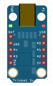

Step 1: Connectintg the Programmer
Place the Trinket on the breadboard.
All pin numbers on the programmer are physical pin numbers.
Connect the following pins:
Programmer Trinket 1 Rst 4 GND 5 #0 6 #1 7 #2 8 BAT
