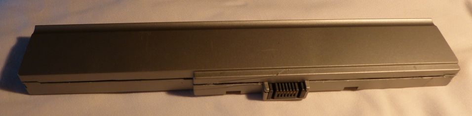

OK, I still have the Dell, but the batteries are way overdue to replace. But now I have a 5 year old Averatec and I have replaced the battery once already. It is now seldom used – only when I need to run XP. The battery started exhibiting the same symptoms as above. It also would go dead in a short time just sitting in the off condition (not sleep). Time to try again.

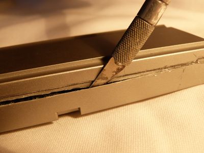

I carefully separated the glued clam shell plastic and opened the case. The trick to separating them is to figure out how they went together. In this case, I carefully inspected the obvious separation gap to determine which half went INTO the other. Other battery packs may be screwed together or just snapped together. This is the hardest part, figuring it out and getting it open. Sometimes, multiple methods are used and screws are often covered with labels. You can find hidden screws by running your nail or other dull object, like the back end of a ball point pen, over the plastic. If you hit a soft spot it MAY be a screw hole. It could also be a mold mark in the plastic. You will have to dig to find out.
Sometimes none of this is “obvious”. Once I determined this I slid an Xacto knife into the split.
It went in pretty easily. If I had chosen the wrong side it would have been more difficult as I would be cutting plastic and not glue. I then ran the knife all around the case till all sections were loose. Be sure to insert knife at a steep angle so as not to damage anything inside. (Do be careful, those knives can do bodily harm.) Off it came. There were no screws.

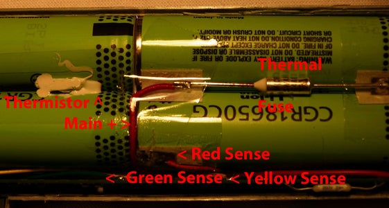

This unit has 8x 18650 lithium cells arranged 2x4. The capacity is 2x whatever one cell is. That is difficult to determine from print on the cell since there usually is none regarding AHr and if there is it is usually an overstated lie.
I then measured the voltage on each parallel bank of cells. They were all pretty much the same. Shutdown voltage was 3.7v or about 14.8V total. Fully charged it was about 15.8V. This pack was pretty easy, some are not because of how they are arranged or the lack of convenient points to place a voltmeter. It may be difficult to determine how they are connected. I had one pack that I had to remove the batteries to figure it out.

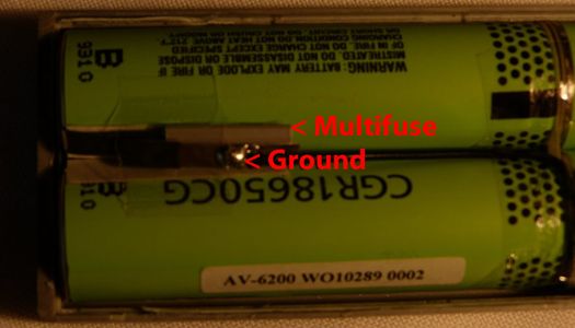

As you can see, this pack is 2x2 in line with a wire going to the PCB from each junction. Note that there are three protection devices – a thermal fuse (silver cylinder), a thermistor (covered in white adhesive), and a multifuse.
The monitor point wires are Black (ground), Green (1st cells), Yellow (2nd cells), Red (3rd cells), and main + (4th Cells). The Black wire is the main negative line. The Red wire coming from the end of the thermal fuse is the main positive lead and the 4th cells monitor line.
If the cell voltages are pretty much even, then there is a good chance the reset is going to work. If any cell(s) are very different from the rest (one cell being 2.4v and the others being 3.7v for example), odds are against a reset fixing things. Makita drill packs are famous for failing this way. However, I have revived one of those, but that is for another Instructable.

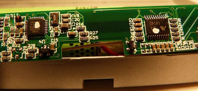

Now you must determine which IC is the microcontrollers. It is either the largest one or the one with the most leads.
Here you see a large IC with 20 pins and a smaller one with 32 pins, 8 on each side. My first choice is the smaller one. It is an Amtel Mega 168 (as read from the IC). I googled this and found a datasheet. It is indeed a microcontroller.
The data sheet info that I need is:
1. Which pin is reset? – in this case it is pin 29 or the 4th from the corner CCW with the index mark on it. I followed the circuit trace on the PCB to a resistor/capacitor junction (typical for a reset pin circuit) and chose that spot to use for resetting (the IC pins are just too close for me). As long as there is no direct Vcc pins nearby you can probably get away with an accidental contact to adjacent pins. Here the Vcc pins are on adjacent sides so I am well clear if I chose that.
2. Which level is reset? – in most cases it is ground. It is usually indicated by labeling "reset" with a line over the top – that depends on company policy. If there is a line, it is ground to reset. If there is not a line further reading may be advisable. Since I can't easily create an overscore I will use a "#" --> #reset.
I’m ready. I connected one end of a test lead (wire) to the black wire on the battery and touched the R/C junction slowly a few times for good measure. I plugged the battery back into the computer and plugged in the charger. This time it took over an hour to charge. A GOOD SIGN!
