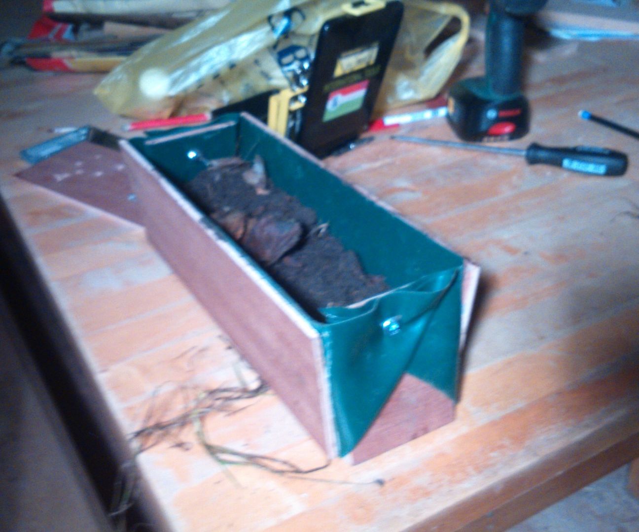

Drill 2mm holes in the left section of the panel. you can drill these randomly.
Put tiney shaft in each hole and glue them. these will form the first obstacles.
The basket:
make a basket with te follow dimension 100x80x50.
To make the traps you need a milling machine.
You need to cut 5 holes witch are 100mm long and 20mm wide.(see last picture)
On the backside of the panel you need to make baskets who catch the water and guide it to somewhere else.
To guide the water you need to get some plastic tubes.(see last picture)

Drill 7 holes with a diameter of 8mm.
Place the moving taps in the holes but don't glue them it is essensial that they can turn.
The last parts you need are the sheet metal baskets (see 4 drawing) you made earlier. screw them under the moving taps so they can catch al the spilling water.
