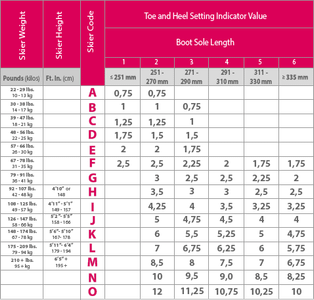

  • Din Chart- A den chart is a measuring chart that measures height, weight, boot sole length, age, and skier ability. This chart is crucial when adjusting skis.

    Step 5: Adjusting the Ski Bindings to Ski Boots
    1. Time to adjust the ski boots to the ski bindings.
    2. Measure the sole of your boot in millimeters.
    3. Obtain your current height and weight.
    4. Now get your den chart. Notice the top bar lists different sole length sizes and the side bar on the left represents a height and weight ratios. This din chart is like a graph.
    5. Start with going down the side bar and finding your height and weight. If your height and weight do not appear in the same category that is okay. Go with whatever block you fall in that comes first.
    6. Mark the block with your height and weight or either or and go to the top of the paper and mark the range what your sole length lies in and mark that as well.
    7. Draw a light line coming from both of the points and where they intersect, is your den setting. This number is very important is the next couple of steps. NOTE: If you are 9 and under or 50 or older go up one den setting. If you consider yourself to be intermediate go down one and advanced go down two.
    8. Look in the middle of your binding, if your binding is not a two piece, there will be small lever and some numbers. These numbers represent the sole length.
    9. Slide the binding up until your see the range where your sole length lies between. Let go of the lever and it should now be locked in place. Give a nice tug just to make sure it is secure.
    10. If you binding is a two piece, set the bet in the binding and see how it lines up. Depending on the model there should be a screw hole to adjust the length of the binding. (8:40-9:05)
    11. Grab your boot and try to set in the ski binding (for either type of binding).
    12. Notice how your boot lines up with the binding.Remove the boot. The goal is to have tight secure fit. To obtain a precise fit, look on the back part of the binding, there should be one small lever on each side of the ski or a big screw of some sort. Push them down and slide the back part of the binding up or down (depending how it lined up) to about a half of an inch short of the boot. . Meaning is about a ½-inch overhang on the boot to the binding.Or if you have a screw, do the same thing but instead of sliding, screw.
    13. Put the boot back on the binding and push hard so that the boot locks into the binding. Once locked look at the very back part of the binding, there will be little grooves of somesort, the ultimate goal is to have half of the grooves hanging once the boot is locked into the binding. This controls your forward pressure. Sometimes it may be off a groove, but always try line it up in the middle. This may take several times of sliding that back part of the binding. It is crucial that you line it up as close to the middle as possible, other wise your bindings will not release properly when falling. (10:07- 11:20)
    14. Keep both boots in the skis after aligning them to the midpoint. Grab your flat head screwdriver and look at the front and back of each binding and there will be numbers and a screw.Turn the screw gently to your din setting. NOTE: If you ever change boots or you gain or lose a lot of weight. Re- adjust the skis to your condition.
