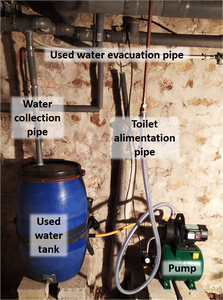

Step 2: My Own Setup
In the case of my house, the evacuation pipe for the cloth washing machine, the shower and the bathroom sink is directly exposed in the basement under the toilet area. To reuse the water i only need to use a water baril to collect the water and send it back to the toilet via a pipe that I added for this use.
In the next step i will go through each element in more details.

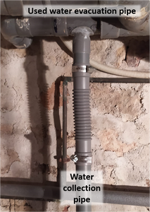

Step 3: The Collection Pipe
Evacuation systems are made of large diameter PVC pipes. Toilets pipes are generally in 10cm diameter while "normal" water water evacuation is often in 5cm diameter as they have less "solid content" to evacuate. To collect the waste water the most elegant way is to cut your existing pipe and to add a T connection oriented to the bottom. PCV pipes are easy to glue and form water tights joins, you can look here for a demonstration: https://www.youtube.com/watch?v=QQF_XDISuSw&ab_channel=EwingIrrigation%26LandscapeSupply
If you don't feel like doing that you can also pierce the pipe and glue a connector like i did here, but there are a few things to remember. The waste water contains particles and hairs from the showers. Those hairs can agglomerate on small asperities and end up clogging your pipe. For this reason you should thoroughly clean the cut from any chipping left after the cut and keep an access possible for maintenance.
After piercing the "least dirty" method consists in gluing or fixing a T saddle piece on top of your hole use it to connect your collection pipe. Alternatively, you can use a hot gun to form a piece of pipe to the shape of a saddle and glue it on the hole. I did it in this case as I was kind of forced to but I do not recommend it. If you choose this method anyway I recommend to first extend the tip of the pipe using a conical shape before forming it with the pipe it will be glued onto. For examples of PVC heat forming you can look here: https://www.youtube.com/watch?v=xRZzTnd9rko&ab_channel=fearlessdoer
As you may need to dismantle your installation to install or open the reservoir i recommend adding a flexible piece of tube. This will help you for maintenance and can also provide an access point to the connection as it doesn't need to be permanently fixed.

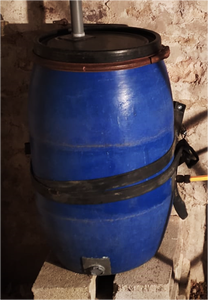

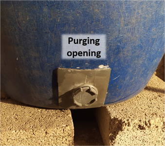

Step 4: The Water Tank

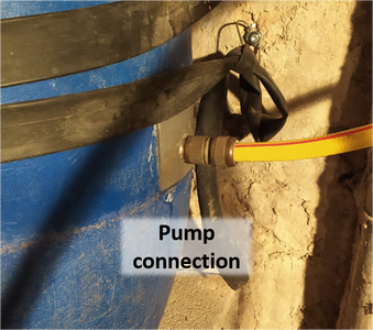

For the water reservoir i used a 120l baril i had in stock, but a few modifications are required. Most pump system will accept particles smaller than 1mm and hairs would not pose a problem to it, but the water valve system in your toilet has a different opinion, and particles can definitely trigger a malfunction of the system causing the water to flow into the toilet until your reservoir becomes empty. For this reason a particle filter is required. To minimize maintenance I elected to install a large filter inside the reservoir (made with a stocking extended on an inox wire armature). The filter and the water output are placed about 20cm higher than the bottom of the tank in order to let the particles decant to the bottom and not to be aspired in the system. I also added a purging hole at the very bottom of the reservoir to remove all the residue once in a while. This method reduces the effective size of your reservoir and facilitate the fouling of the water, it should only be used if you expect a lot of particles in the water (my shower is often used to wash dogs...). Otherwise a simple filter like this: https://www.amazon.com/Winb-Double-Layer-Encryption-Connection-Strainers/dp/B0B35VBMPL/ref=sr_1_12?keywords=water+pump+inlet+hose&qid=1674976606&sprefix=pump+inpu%2Caps%2C290&sr=8-12 placed at the bottom of the tank might be enough.
You may also prefer to add a filter like that: https://www.amazon.com/Sooprinse-Garden-Pressure-Sediment-Attachment/dp/B07Y1JYQJZ/ref=sr_1_11?keywords=water+pump+inlet+hose&qid=1674976606&sprefix=pump+inpu%2Caps%2C290&sr=8-11 later on your installation to have an easier access.
For my installation i made the connections by doubling the tank's walls with a heat formed PVC layer glued with cyanoacrylate (PVC glue doesn't work on the polyethylene tank). I could then pierce and use PVC fittings. This is once again not the cleanest way to do and I would recommend instead bulkhead tank connector like those: https://www.amazon.com/Joywayus-Connector-Theaded-Bulkhead-Stablizing/dp/B07GPP23K9/ref=sr_1_5?crid=NHZYB08AKFL7&keywords=Bulkhead%2Btank%2Bconnector&qid=1674976442&sprefix=bulkhead%2Btank%2Bconnector%2Caps%2C276&sr=8-5&th=1

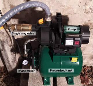

Step 5: The Pump and Pressurized Tank
Pressurized pumping systems can be bought for a few hundred USD online. Those systems are often used to pump water out of a well and are composed of a pump, a tank with a membrane and a pressure control system. The tank is composed of two compartment separated by an elastic membrane. One of the compartment contains water and the other air. When more water is introduced it deforms the membrane and compresses the air. That way the uncompressible water can be stored under pressure. The pressure control system monitors the pressure and start the pump when it drops below the threshold.

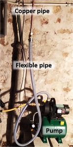

For this application a low cost pumping system can be used as there is no need for high pressure (here low pressure only means that the toilet reservoir will be filled more slowly after flushing) and the capacity of the pressurized tank is not important. Furthermore low cost generally mean low pump power and low noise which is a benefit for an installation indoor. However there are two important things to look for: Does your pump includes a one way valve at the input and does it have an automatic stopping mechanism in case the (non pressurized) water reservoir is empty.
The one way valve is not systematically included and is absolutely necessary. Without it the water of the pressurized tank will be driven back to the system input when the pump automatically stops after reaching the threshold pressure. In my case I installed a valve at the input as shown in the picture. The connection to the reservoir upstream of the valve is not pressurized and can be made with classic garden hose.
I do not yet have a water level safety switch to stop the pump and i plan to make one in a future still to be determined. The function of a water level switch is to stop the pump when the reservoir is empty. In its absence the pump will be unable to push enough water in the pressurized tank to reach the threshold and will continue to run indefinitely until breakdown. In the absence of such a switch make sure that your water input is largely superior to the toilet consumption or that you can hear the pump running to be able to react if it stays on for too long.
Like most water pumps, this system needs to be primed (ie. filled with water) to begin pumping. To simplify this step you can put the pump slightly below the water level in the tank and just flush your toilet to open the valve and let the air go out of your system.

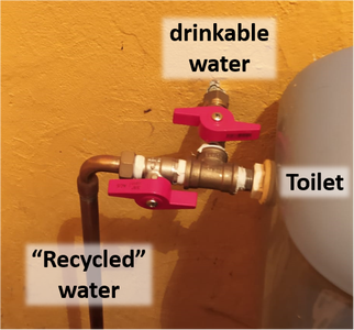

Step 6: Toilet Alimentation Circuitry
To connect to the toilet i elected to keep the existing system and install two valves to be able to select between "recycled" water and drinkable water. This is slightly more complex to install than just re-using the existing pipe but it allows to easily come back to drinkable water in case the pump has an issue. On the pump side it is better to use a portion of flexible tubing to avoid transmitting the pump's vibrations and to make installation and maintenance easier. However that portion of the piping is under pressure (typically 2 to 5 bar depending on your pump) and the pipe and fittings should be adapted (typical garden hose will not age well under those conditions).
