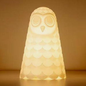

They sell a table lamp called Solbo (1st picture above) that is available, at the time of writing, since about four years at least. It is equipped with a low-voltage, 24 V DC LED bulb and a matching wall wart (which means it is safer than if it were operated directly from the mains, and therefor it is recommended for kids).
