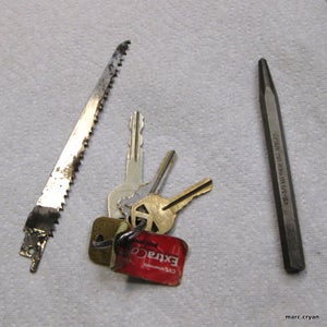

Step 1: Materials
Stuff:
- Sawzall Blade
- Center punch
- Grinder Dremel bit
- Drill
- Bench grinder

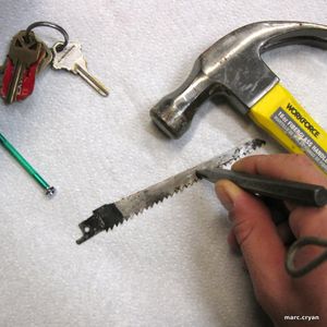

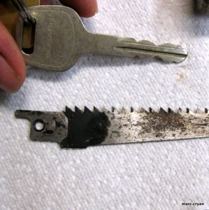

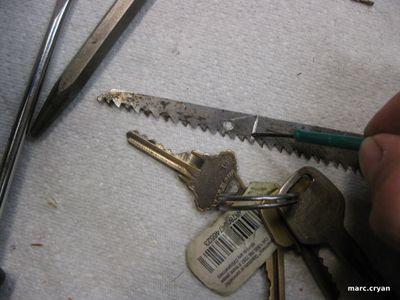

Step 2: Mark Hole and Length
I wanted this to be about the size of a key - so I used my keys to determine the length.
I used an old screwdriver to make scratches to mark the length and hole.

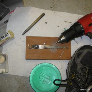

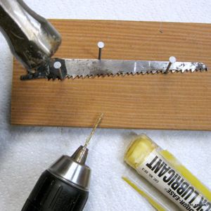

Step 3: Start Hole With Center Punch
Use a center punch to start the hole. This will keep the bit from drifting around as you try to start the hole.

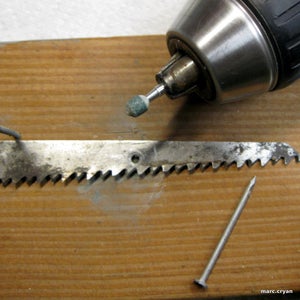

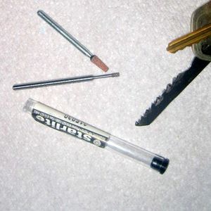

Step 4: Make a Hole
It took a long time to make a hole in the blade.
I tried a regular drill bit with poor results.
A blue grinder from a dremel kit worked well, the bit was nearly destroyed.
I made a jig by putting nails into a board very close the blade.
Step 5: Is the Hole Big Enough?
Test the hole.
The hole here is a little too small to fit over both rings of the keychain. Measuring the keychain, the hole needs to be almost 0.2"

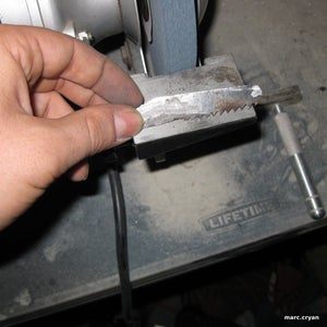

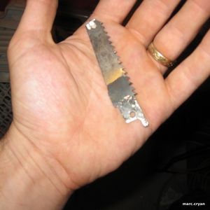

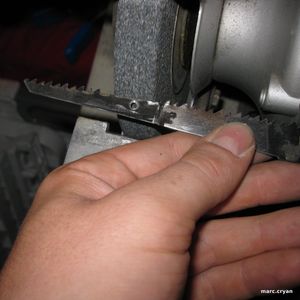

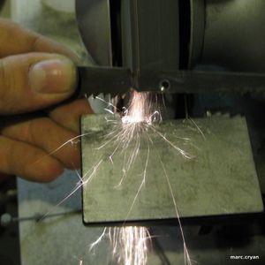

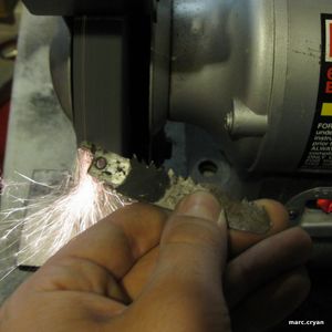

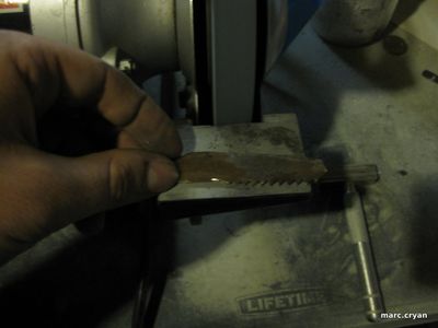

Step 6: Grind to a Shape

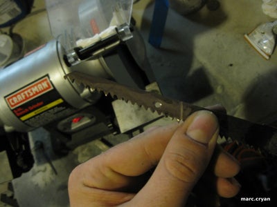

I used a bench grinder to shape the saw.
Removing several teeth makes the saw easier to hold.

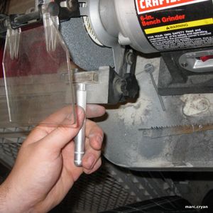

Step 7: Polish on Grinder
To clean up the sides of the blade, use a fine grit wheel and a light touch.
Step 8: Cut to Length
Cut the blade to length on the square corner of the coarse wheel.

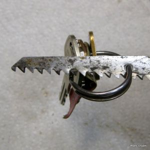

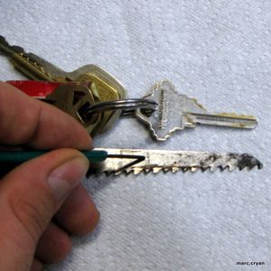

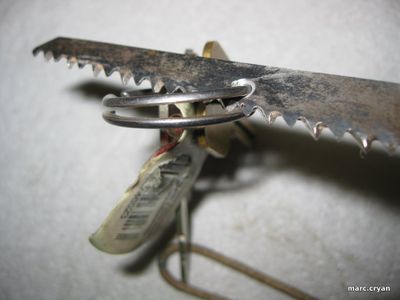

Step 9: Put on Key Chain

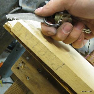

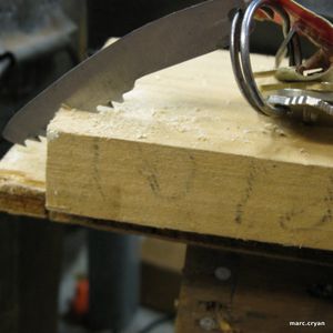

Step 10: Test It Out
The sawzall blade cuts on the pull, so the key chain and keys can be used as the handle.

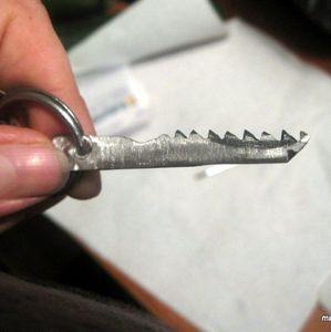

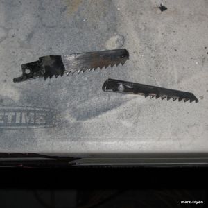

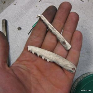

Step 11: Make Another With the Other End of the Blade
The fat end of the blade can be made into a second tool. This part already has a good size hole.
Step 12: Grind Shape and Polish
Shape on the coarse wheel and polish on fine.
I tried to give the back of the blade a curve. Also ground off several teeth to make a little handle.

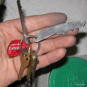

Step 13: Now We Have 2
Here are the final pieces.

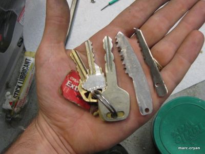

Step 14: Put Them Both on a Key Chain
Step 15: Test It Out
This one is pretty beefy.

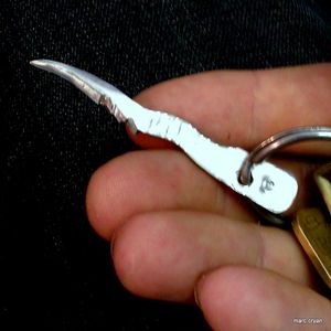

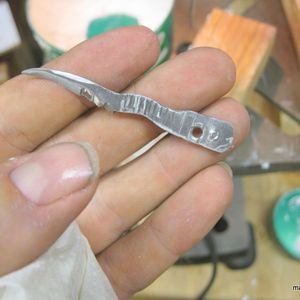

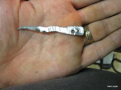

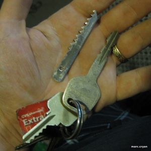

Step 16: Make Better
I've changed the shape to make this a more practical hand tool. As a saw it just ripps stuff, this is more like a small knife or x-acto blade.
It is now pretty kick-ass.
I will(might) post details when(if) I get a chance.

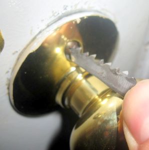

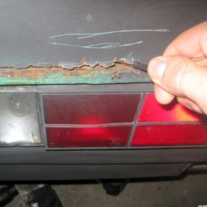

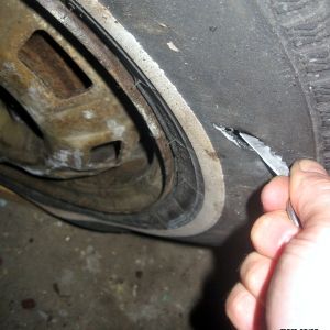

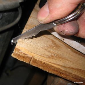

Step 17: Testing Some More
Here are some more images of the saw in action. It is tough enought to screw in a screw, cut a tire, mangle rusty car metal.

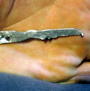

Step 18: Problems
The saw is good, but it does more ripping than cutting. There is also a spot that digs into my finger.
Step 19: Shaping Tools
Here are some dremel tools that are able to grind the tough metal.

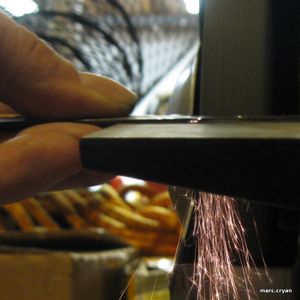

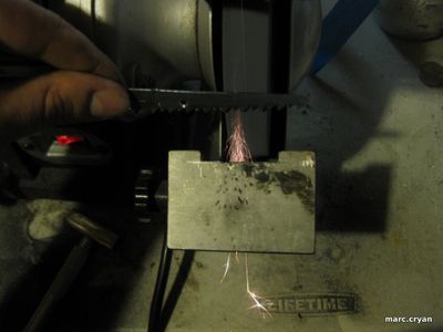

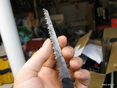

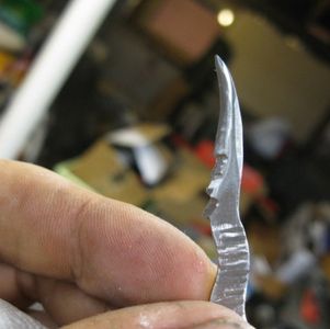

Step 20: Start of the Grinding Wheel
A bunch of the teeth have to go, in order to form a blade. The rough cutting is done on the grinding wheel.

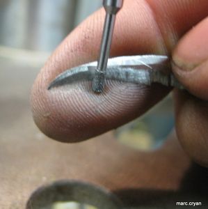

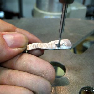

Step 21: Detailed Work With Dremel Tools
The inner curve was hard to get right. I put the dremel grinder in a drill press and held the knife in my fingers.

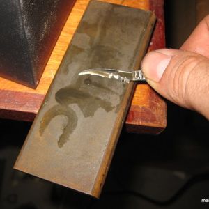

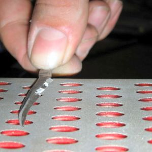

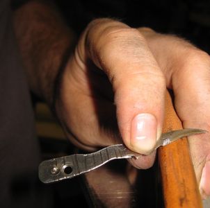

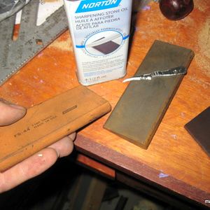

Step 22: Sharpen
The blade is only angled on one side (like a chisel). The back is flat. This allows you to sharpen the knife be pressing the flat side against a flat sharpening stone.
Step 23: Sharpen the Curved Side
I have some fine stones with curved edges. I have these for sharpening curved wood lathe chisels (gouges). They need honing oil and can produce a very sharp edge -- probably sharper than is really needed.
I sharpened these by going back and forth between the curved side and the flat side. You sort of get a little sharp edge that bends back and forth, when it is gone the blade should be very sharp. I test the sharpness by dragging the blade gently across my fingernail -- it should immediately catch the nail. In some of the pictures you can see little chunks of my finger nails missing from this. A dull blade will just slide across the surface.

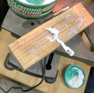

Step 24: Polish
I got a decent polish by rubbing the knife on a piece of wood covered in a fine rubbing compound (for a car). At this point the tool is tiny and sharp, so it was pretty hard to handle.
There are dremel tools that are grit and rubber -- but I didn't have any on hand.
