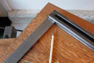

This is some scrap 1/4 inch plywood. Neither of the two edges visible is straight and true. I used my tri-square to mark a straight line so I can trim the plywood for a true edge. See this Instructable to make this tri-square

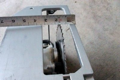

I needed to measure the distance from the edge of the saw blade to the edge of the saw's shoe or base. It is 1 1/2 inches. That does not include the thickness of the blade, which is a factor in some cuts, but not in others.

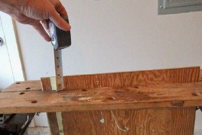

My piece of plywood is narrow enough that it fits between the two screw assemblies that pull the jaws of the Workmate together. The construction of the Workmate limits the width of material that can be sawn this way, but I am interested in sawing small pieces safely, so the method fits what I need.
I have positioned and clamped the piece of plywood in the Workmate so a little more than 1 1/2 inch extends above the Workmate surface.

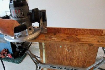

The top surface of the Workmate jaws are very straight and true. I rested the edge of the saw's base on the top surface of the Workmate while holding the base as near to exactly vertical as possible. Pull the saw's trigger switch and trim the edge of the plywood. Checking with a straightedge showed the plywood now has a straight and true edge.

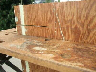

I needed only four squares 3 inches on a side. I measured inward from my new true edge 3 inches plus 1 1/2 inch for the distance between the blade edge and the saw blade. I added 1/16 inch for the thickness of the blade. I made a line at 3 inches and another at 4 9/16 inches. I used this second line to align the piece of plywood in the Workmate. This second line is even with the top of the Workmate's jaws.
You can see the saw's kerf. I wanted the blade to cut just below the line so I have exactly 3 inches remaining on the piece I am ripping. The line is visible and the kerf is positioned correctly so that exactly 3 inches remains.

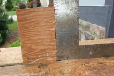

Once I had ripped a piece 3 inches wide, I needed to cut from it to make 3 inch squares. I positioned the 3 inch wide piece vertically between the jaws of the Workmate so that 4 9/16 inch extends above the top surface of the Workmate's jaws. I used a square to insure that the piece is at exactly 90 degrees to the top of the Workmate's jaws. I sawed as shown in step 4.
