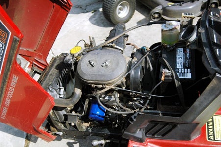

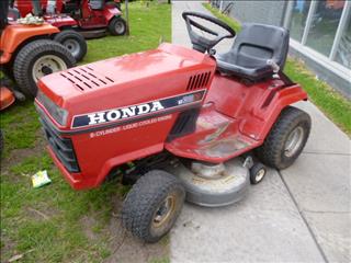

I have a 13hp Honda 2 cylinder water cooled engine from a lawn mower I will tear apart...it's a 2 cylinder, electric start, and amazingly quiet. The mower is going to supply a bunch of parts, an engagement system for the band, throttle and electrical controls, a ready made engine cowl (way cool for a saw!) and maybe even a drive system for the carriage. I bought it for 50 bucks because it needed a starter that from Honda is EXPENSIVE! (I found a used one on e-bay for 40 bucks)

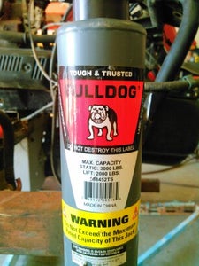

4 jacks to raise and lower the saw

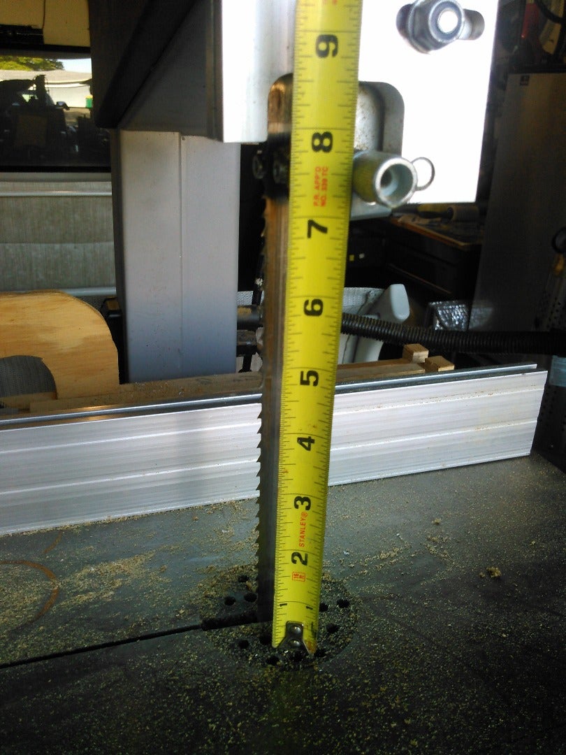

The actual working space is only about 7", so I'll have to widen that to fit a fairly good sized log, say 16-18", the depth of cut is fine at 12" so I could in theory cut a 12X12. Here in Florida I don't get logs or poles larger than that, so why go bigger.
Once lengthened, I'll go to a larger blade designed for lumber cutting, not finish work.

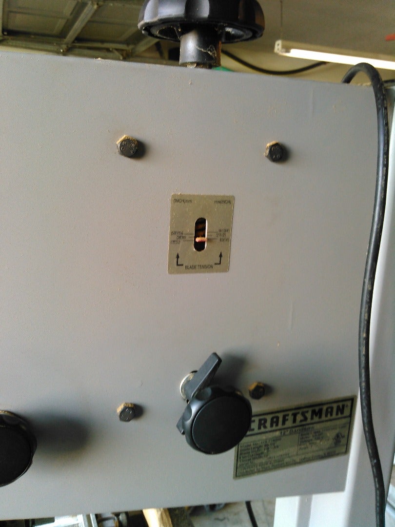

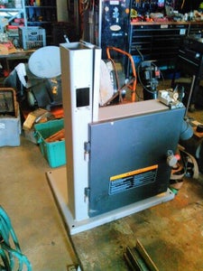

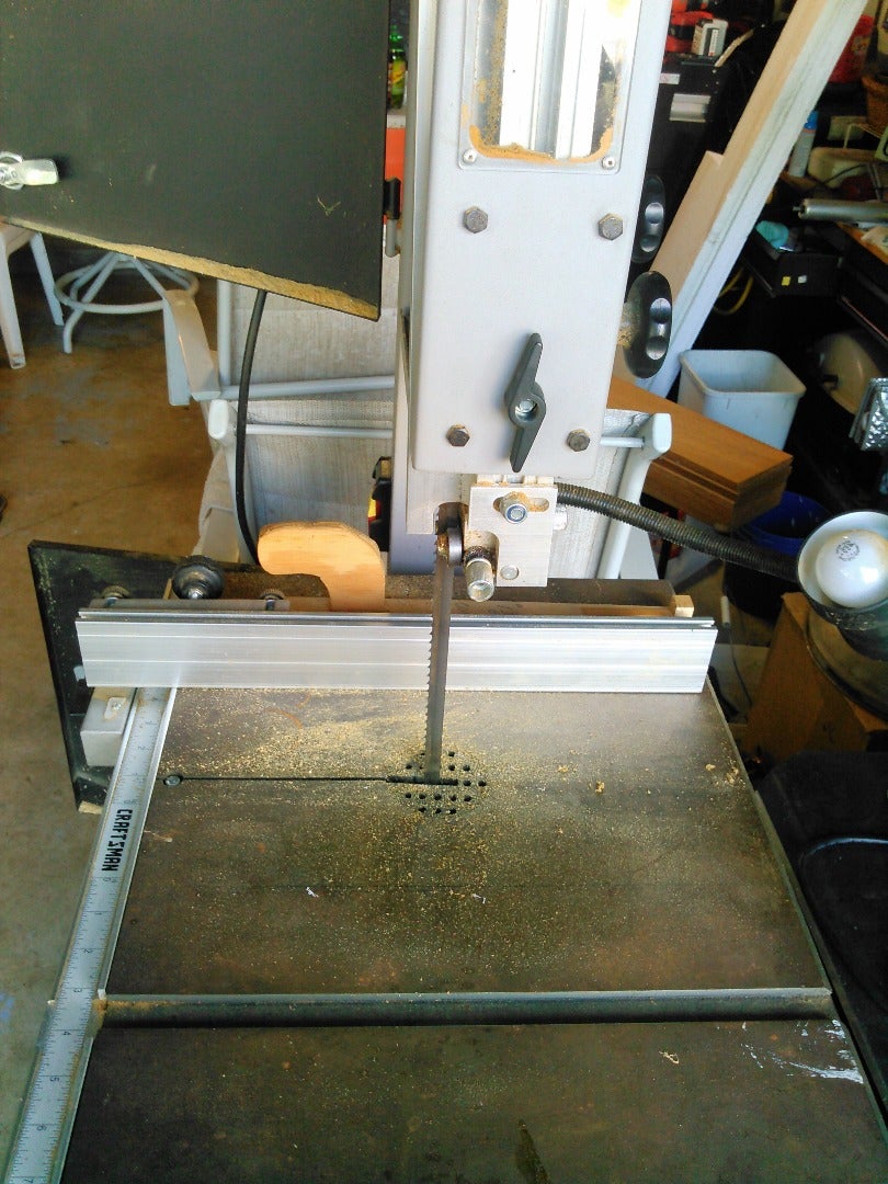

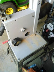

Step 5: The Saw and Mower Hack

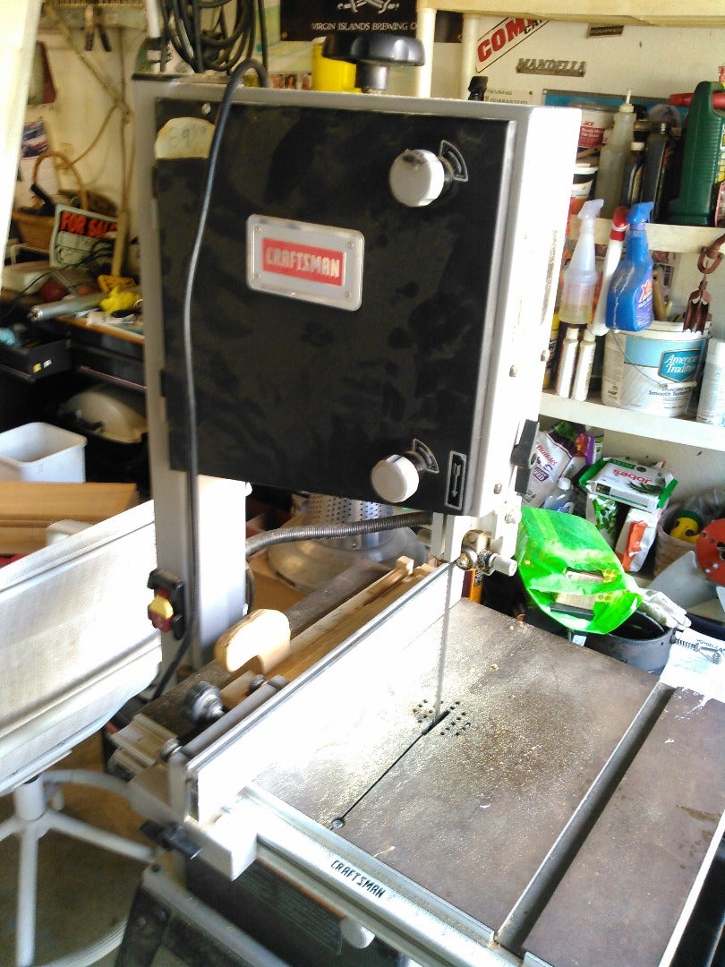

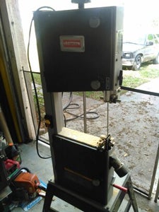

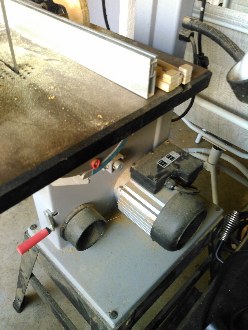

My first step is to hack up a perfectly good saw, which in my opinion is much better than jumping from a perfectly good airplane for fun or getting slapped in the face with a dead fish.
I'll remove the electric motor, blade and the wiring as we are going gas.

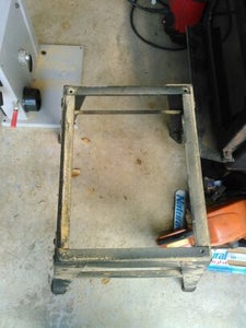

I'll then remove the table.
I'll leave it on the base because it is heavy, and to make it easier to plan cut for extension parts.

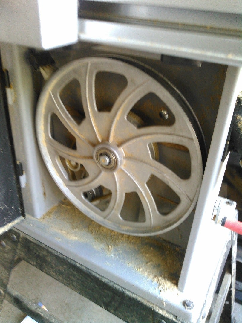

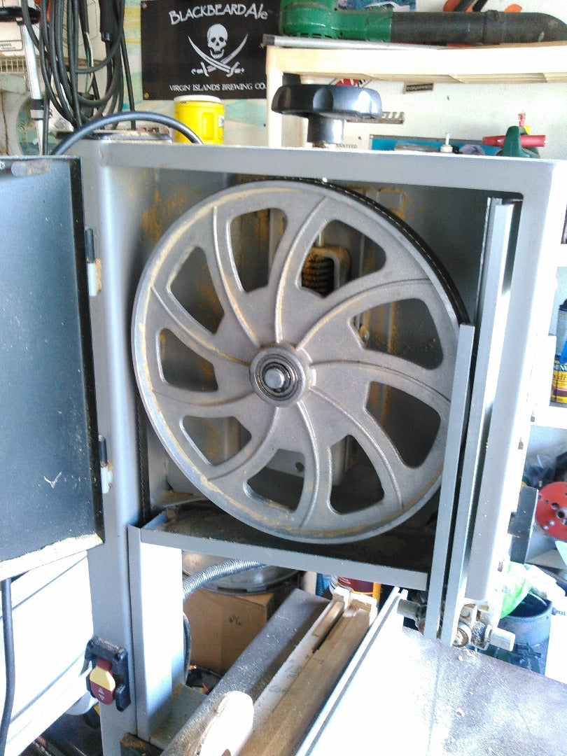

As you can see, using an existing saw comes with many advantages. The wheels are perfectly sized and carry sealed bearings, it has the alignment adjusters already designed and even has a blade tension adjuster with a gauge. Plus, it has an adjustable blade guide, so when cutting smaller boards you can close up the blade exposed length making your cut more accurate.
When you plan this part, plan your overall cutting area, as well as how your guide will move, how much "meat" you have to attach your extension to, and then sit and rethink it all 10 times before you chop it up!!! As you can see from the picture, I didn't use my own tip #3 from the previous page. That was because I have a metal cutting band saw. I cut it after making sure the tube was straight and chopped away! This particular saw has a box tube as its "backbone". The size of the tubing is an odd one, not available so I just used a slightly smaller piece I had and then added angle iron on the outside for added strength.

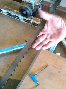

Because I used an existing saw with a spec tag on it, once I extended it 12" it was easy to go on line and order blades. I just added the 12" we extended (times 2) and ordered blades from Spectrum Supply:
Woodmaster C
Length - Feet: 9 - Inch: 5- 1/2"Width x Thickness x TPI: 1" x 0.035 x 1.3T
These blades are reasonably priced (about 15 bucks each) and can be made in any length you need, and with a variety of configurations.
I also have to cut up a mower; be sure to have a drink and think this over for a while first, you don't want to cut it up wrong and then try to figure out how to fix your screw up. As yours will probably be different, I won't go into a lot of detail on the mower. You will see in the next steps how I cut and used a lot of it.

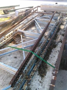

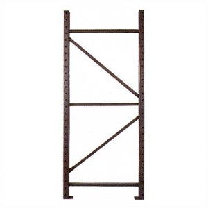

My rail setup will consist of a 16' section of shelving support. These are the type the large box stores use. The ends are reinforced, and very strong. They are also already square, so no worry about tracking to start. I'm primarily going to be cutting wall studs, 2x4's, 2x6's, 2x8's, some 4x4's for fencing, and just maybe 6x6's for barn posts.. All of them will usually be less than 12'. My one section will allow a cut that long, but I want the ability to cut to 16' so I'll make an attachable extension for longer boards.
As I made no modifications, I failed to take a good picture of the actual rail. It is; as you will see a standard end for commercial shelving. The reason I chose it was because it was free and luck had it that it had a channel that was facing out, thus allowing me to place a wheel on top and a guide wheel in the slot for straighter tracking.
Well, sometimes even the best plans change. A local boat dealer was modifying their building and I scored I-beams that will be much stronger and also longer. So, hundreds of dollars worth of I-beam that was going to the scrap yard is just better. Because the logs I will be cutting are so heavy, I was planning on reinforcing my rails, but now I can use these I-beams and not have to. Also, they are longer, so I won't have to make extensions.

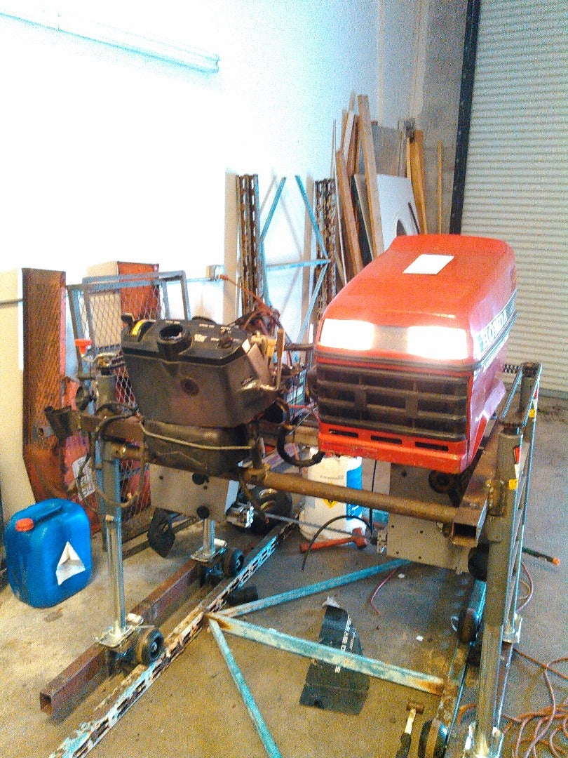

Here is where you have to play around with your design a little. Or a lot. Many beers were found empty before the final ideas started to gel. Here we go:
Your cradle is going to carry everything, the engine, fuel and water tanks, battery and of course the actual saw. That adds up to a bunch of weight. I have seen a bunch of home built saws using two lifts, or a cable and pulleys, but remember the weight you have to move? Well four is better than two. I chose to use trailer jacks, with a 17" lift, so if the saw weighs 300 pounds each jack is only lifting 75...less wear and much easier to turn the handle. I purchased these new for about 70 bucks each, because I wanted them identical so that they moved the same amount with each revolution of the handle. Plus as they are going to be welded on I didn't want used ones that would wear out too soon. These are from Tractor Supply, and have a 17" vertical travel. I am going to have one handle control all four jacks, attached together with chains. This way all will move at the same rate and maintain level. For wheels to ride on the cradle, I searched for strong wheels that could take a beating, but most of the wheels I saw with brackets and bearings were ridiculously priced for the job. Here is where a little shopping is important. I found solid hard wheels at my local lawnmower shop for 8 bucks a piece; just deck wheels for a riding mower! I then chucked them up in my lathe and cut a flat surface to true them so they glide on the rail smoothly just in case they weren't perfectly round. I then took a piece of 3" angle iron and welded two nuts on it, then slid the bolt through the wheel and ta da! Not only did that work for the vertical wheel, but it also worked for the guide wheel and pad for the jacks! Be sure to keep the shaft greased and no problem! Another beer! The guide wheels are just inexpensive 4" wheels with brackets from Tractor supply, remember they carry no weight so they don't have to be crazy expensive ones.
The actual cradle has to be strong, but also reasonably narrow so as not to use up too much of the rail. I decided to mock the saw on blocks on top of the rail and see where it sat. As you can see in the picture, the cradle in its first mock up is on the rails, with one set of jacks in place. We also installed a temporary brace at the front of 2x2 box just to keep square.

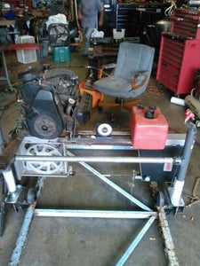

Step 8: Fitting Everything on the Cradle

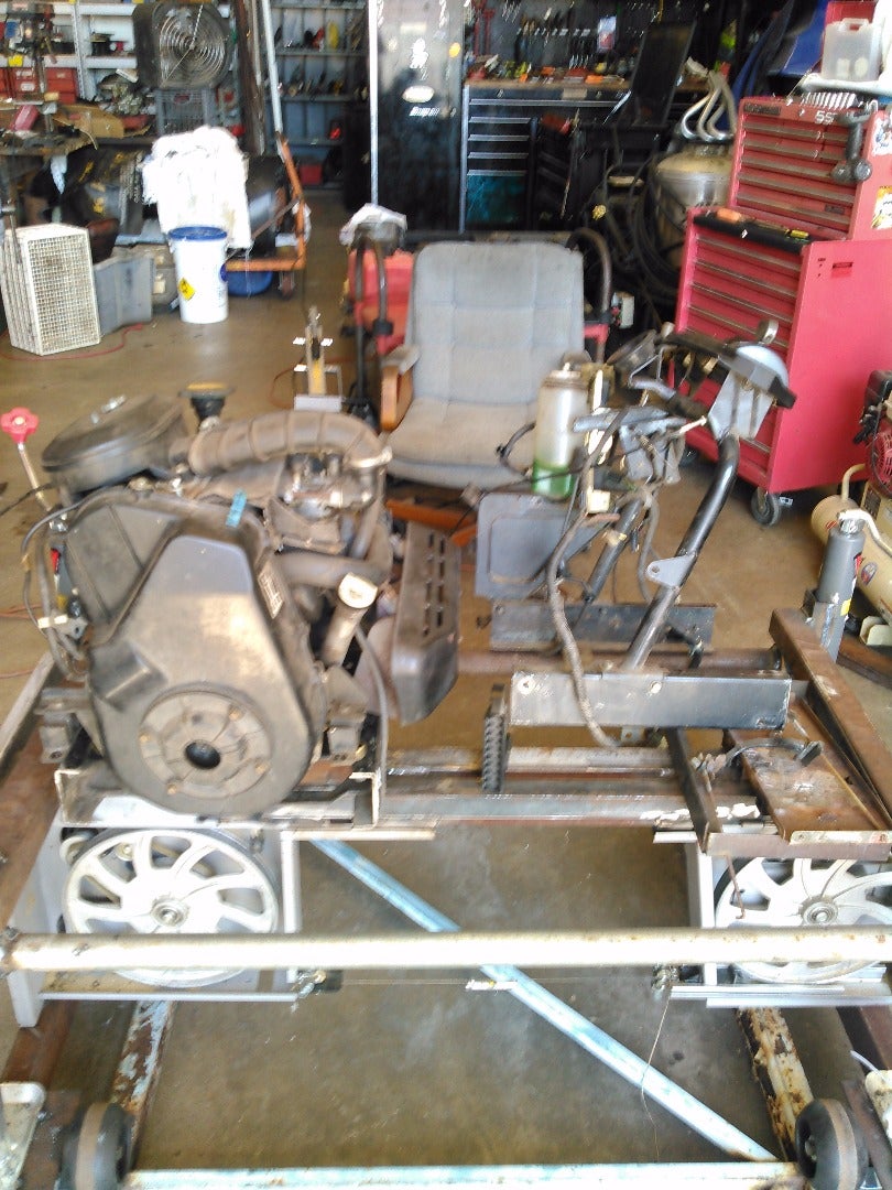

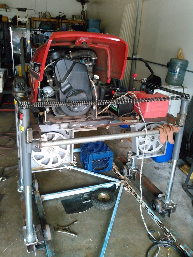

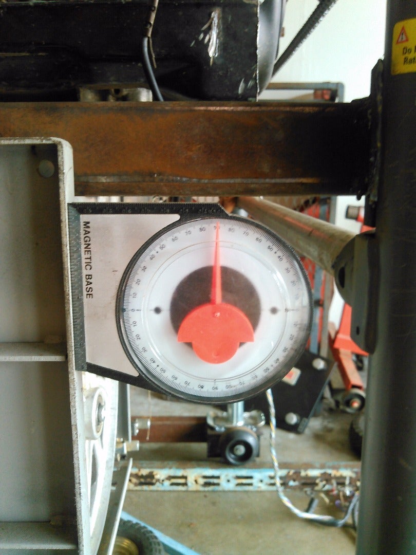

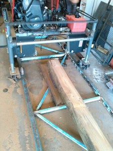

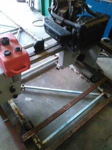

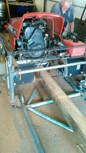

OK, I have a cradle that rolls, a saw laid on its side...now I have to mate them and start to figure travel height, fitment of everything...I started with milk cartons and boards to get the saw level, then I tacked the engine in place to plan drive belt and jack clearances.
******* You must make sure your saw is level at all times during your build BOTH WAYS (side to side and fore and aft), or you will have to adjust it later somehow. If it is not, your blade will either climb out on your cut (up) or down, thus you will never have a true board. Easier now than trying out how to change it later. Yes, you can level with the jacks, but then down or all the way up they will not match, so travel length will be affected.

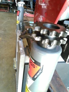

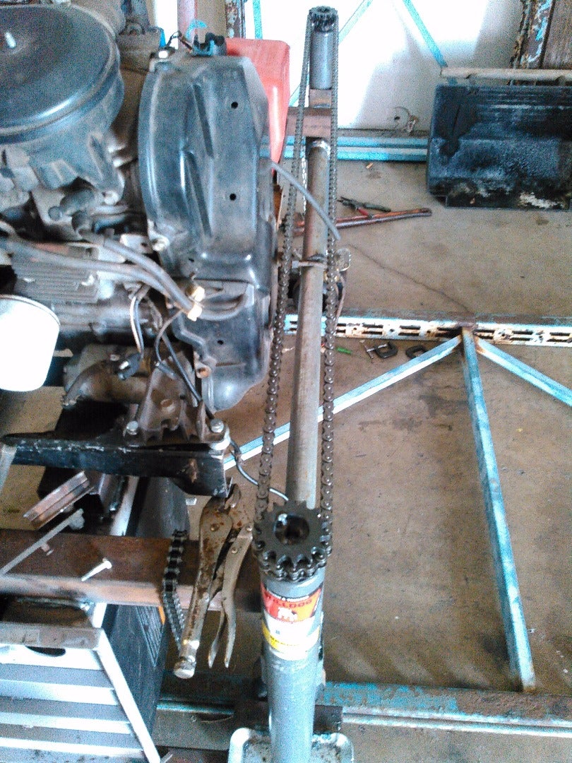

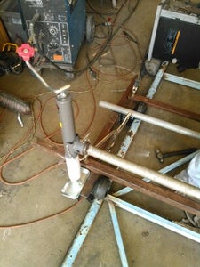

I used thick wall pipe to attach front and rear jacks making sure there was room for chain and gear clearance.
Now that the jacks are in place, I need to attach the chain drive between them to raise and lower the assembly. I'm doing my best to over build the entire machine for longevity...so I purchased #40 chain at Tractor Supply and gears, gear hubs all too heavy duty, but should last a long time. I purchased the chain in bulk, two 10' rolls, and bought a chain breaker also to make it easier to size them. I used master links to connect the ends once cut to length for each section.I removed the handles from the jacks, which is where the hubs will fit. I slid the gear on for the drive jack, and on the other three slid two on spaced for chains to clear. I then welded the gears to the hubs and slid on the jacks. They are held on by set screws. After they were all in place, I welded the handle assembly on top of the drive jack. After the first turn, I realized the crank was either too short or just too hard, so I cut the mower steering shaft, and removed the handle, replacing it with the steering wheel. What a difference and once again used another part from the mower! I also used the old bag attachment bracket from the mower for our push handle.
Note!!!!!It is easier to make the chains up prior to mounting jacks, as if you are 1/4" off the chain can be too loose or so tight you cannot turn the handle. OOOps! Thankfully, I was able to cut the tacks and adjust the jack a little to tighten chain. Because there is very little stress on the chains, stretch should not be a problem, if so I can adjust by taking out a half link is needed.
Notice one picture with dash, one with tank...mocking it over and over...or is it mocking me?
I still have controls and more to add... The engine sits with the exhaust facing rearward, in the middle of the saw, so I will put the fuel tank as far outboard as I can. I will put the battery next to that, with the control panel in the middle area so I can use the existing wiring harnesses and control cables for throttle and clutch. I am even going to use the mower cowl for sound deadening and it will look cool too. I made a mount for the fuel tank from scrap bed frame angle iron and used the mower battery tray by just adding a scrap of box tube to weld it to saw frame. For both comfort for the operator and safety, I added a 3/4" piece of conduit for an exhaust extension, diverting down and away from the control area.

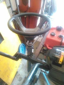

Step 9: Engine Controls, Pulleys Turning

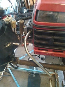

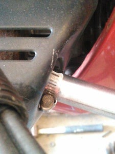

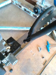

My mock up allows me to adjust distances, etc. so I can hopefully use the original engine and clutch controls. The clutch and throttle are controlled by a cable, so I really don't want to search for aftermarket ones. I moved the engine cradle close enough that I can use both factory cables, once again making replacement easy. Because the engine is facing the opposite way from its original configuration with the controls, I did have to extend the wiring harness. Don't be afraid if you have to do this. There were 7 wires, all color coded, so after I removed the electrical tape, I cut them and just spliced in a couple feet so everything would reach. You can do this one wire at a time if you are afraid you'll get the connections wrong. Because this was a riding mower, if you were not seated, the blades would not engage. So, I easily converted the electrical seat switch to a kill switch. I used a boat kill switch connected to a tether so you can attach to yourself. In the event you trip, or need to walk around the saw, if you go too far away from the controls or close to the blade the entire saw will shut off. SAFETY FIRST!!!

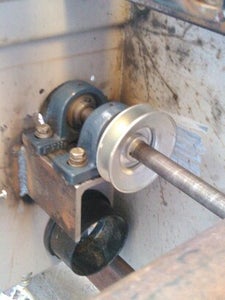

OK, so I'm going to have to make a system of belts, pulleys and bearings to convert engine motion to move the blade. I removed the original pulley from the electric motor. I then took measurements from the motor to figure out depth through the hole in saw housing.
I wanted this part to be strong so I opted for 3/4" pillow blocks. I machined the end of the bar stock down to fit the original drive pulley off the motor. We then tacked a piece of angle iron to the housing once we had the approximate alignment of the belt inside.Once we had that in place, I purchased a pulley that would allow my blade to move at the right speed with plenty of throttle adjustment. I want my blade to run at about 4000 feet per minute (yup, 45 mph!) As the electric motor ran 1740 rpm and my mower engine can run 3600, I reduced my rpm to around 2000 and went with a pulley that will turn the pulley inside at 1740 easily which is 3000 fpm and I can adjust throttle up to find my sweet spot for different wood densities. Mower engines are throttle adjustable governed, so whatever rpm I choose the governor can keep it there unless load becomes to much to compensate for. The old belt from the mower was cut to length so I could go to the mower shop and buy the perfect length belt. A simple tensioner from the mower deck set the tension.
As you can see, I tried different placement for controls and failed at first...mock up is invaluable!

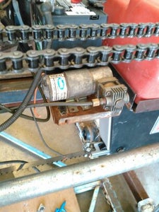

I added a small air compressor I had from a set of air horns to blow off the sawdust and with that included the coolant connected with a "Y" so air forces coolant, under pressure to cool and clean blade at the same time sort of like a mini pressure washer. The coolant flow is adjusted with a simple valve in the line from the tank.

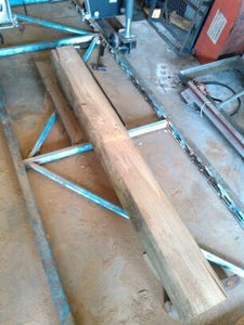

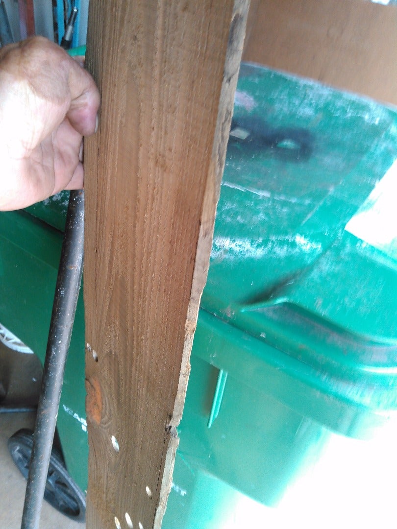

I set up a temporary log cradle under the saw, and threw a 10" power pole 6' long on it.

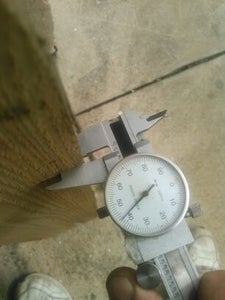

My first test cut tried to climb out of the log, which was caused by interference when I aligned the blade. I found out how sensitive the blades are to metal parts...in ten seconds the kerf was gone. Thankfully I bought more than one blade, so lesson learned. Ya need some clearance, Clarence! The interference took the kerf out of my blade in less than ten seconds. After changing the blade and re-adjusting the tracking, I had success, my first cut perfect flat, and my second EVER 9/64" thick (that's thinner than the diameter of a pencil) 6' long. Less than a quarter inch thick from a bandsaw and a mower. The accuracy is amazing, performance flawless...and for less than a good sized TV costs!
