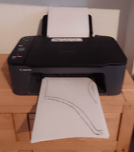

Step 2: Scan Your Drawings & Convert to PNG (if Necessary)
Scan the patterns, ideally in PNG format. Since my printer scans only in PDF or JPEG format, I used JPEG and converted the files afterwards to PNG with a free online converter tool (jpg2png).
I connect to my printer via my smartphone, so I needed to share the files to myself somehow. To do this I used email rather than WhatsApp, because by default WhatsApp compresses images (and we do not want that).

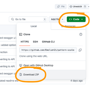

Step 3: Download or Clone Pattern-Scaler and Run It Locally
Option 1: Manual download
Go to https://github.com/Emelieh21/pattern-scaler, click on Code and then on Download ZIP (see image). Unzip the folder.
Open the terminal in the pattern-scaler folder (on MacOS: right click the folder in the Finder and click on "New Terminal at Folder", on Windows: right click the folder and click on "Open in Terminal").

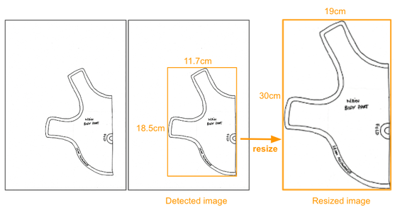

For this, it helps to understand that the pattern scaler works in the following way:
  1. It detects the image in your drawing
  2. Calculates how large it currently is (height and width)
  3. Rescales it to the size you want it to be, either by making it the desired height that you specify or multiplying the current height and width with the scale factor you define
  4. It splits the rescaled image in as many A4s as it needs, so it can be printed
As you can see in the image attached, the image is always detected as a rectangle or a square. It is important to keep this in mind when you are calculating your desired height (especially when you drew your image diagonally).
I want to scale my patter to be 60cm (approximately 25% bigger than it originally was).

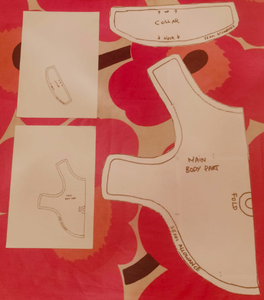

I have added the result of my main body part in attachment.

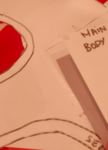

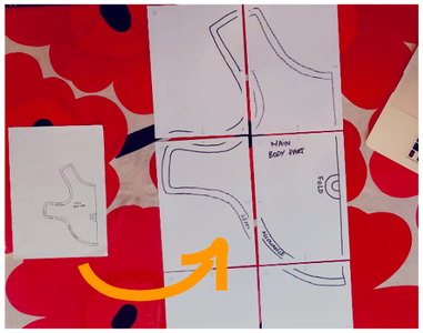

Step 7: Cut Your Pattern and Glue It Together
The pages have lines on the side and letters indicating which page goes where. This should help to figure which parts to glue together. Cut the parts and make sure to leave the extra space on the side on one of the parts that go together (for the glue).
Step 8: Repeat Step 5 Until 7 for Other Parts
I converted also the collar of the jacket to be the correct size, by putting the scale_factor_height to 3.24 (see screenshot). Unfortunately, since I drew this part diagonally, it managed to need four pages for the rescaled version, even though it is a relatively small part. I should have drawn it straight.
