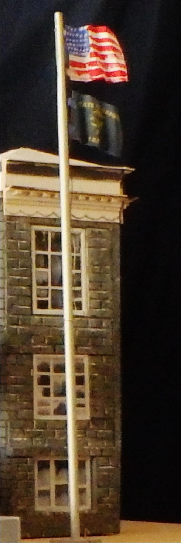

Step 13: Make Flagpole
The flagpole is made of a 1/4 inch dowel, cut to size then sanded on one end to provide a tapered effect. I painted a piece of paper for the American flag while the State of Oregon flag was found online and downloaded and printed. A base for the pole was made with a circular piece of 1/4 inch plywood, drilled and painted as needed. Around that I made small bricks of styrofoam and distressed and painted them to resemble the granite of the building blocks.
