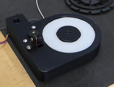

Step 5: Stepper Motor
Install the stepper motor and attach it with two screws and nuts. I just used any 2 matching pair I had in my parts bin. Because the mounting tab is so close to the motor I had to grind down one side of the nuts so that it can fit against the stepper motor. Nice thing is now the nut will not spin and I can cinch the stepper motor up from just the top side of the platform.
Step 6: Backlight LED
Solder wires to the IN, PWR, and GND on the Jewel LED, then pass the wires through to the back side and smoosh down the LED in its position on the base. The Base will have a small cut out that the Jewel should fit perfectly in.
Step 7: Position Sensor
I used some old computer screws to munt this part. Sorry I don't know the sizes of these. Trial and error. But anything you find that works...will work. After fixing the sensor mount to the platform, mount the position sensor to the sensor mount.
Step 8: Light Diffuser
Time to test your skills and cut out a circle the best you can. If you are super cool maybe you have a CNC or laser cutter that can do this. I am not, so had to do it with a coping saw. And the result shows a human cut this out. I used the inner and out trim rings we printed as a template. As long as it fits fairly well in the base it should be ok. We will hide the imperfections with trim pieces we used as a template. Again, just glue down the trim pieces to the diffuser. You don't have to glue the diffuser down to the platform unless yours it not sitting flat enough or you just want to.
Step 9: Reel Support Attachment
Press the bearing into the center of the platform and secure it with the bearing holder. Not sure why I have no pictures of the ball bearing, I honestly don't have anything against ball bearings.
Then pass a long screw through the center as the axel. Long enough to also pass through the reel support and reel mount.
  1. While holding the screw in from the backside, place the reel mount over the axel.
  2. Then place the reel support on top of the reel mount.
  3. Finally add the nut onto the axel to secure them all together.
  4. Screw in the axel until the nut is flush with the reel support.
  5. The reel mount should now spin freely.
  6. Cut the screw afterwards to clean it up.
Step 10: Arduino Time!
Connect all of the wires and install the Arduino as pictured. There is a little cutout in the platform for the USB port to stick out. Also mount the stepper motor controller in the bottom corner of the platform. Dress up the wires to your preference.
