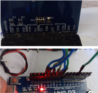

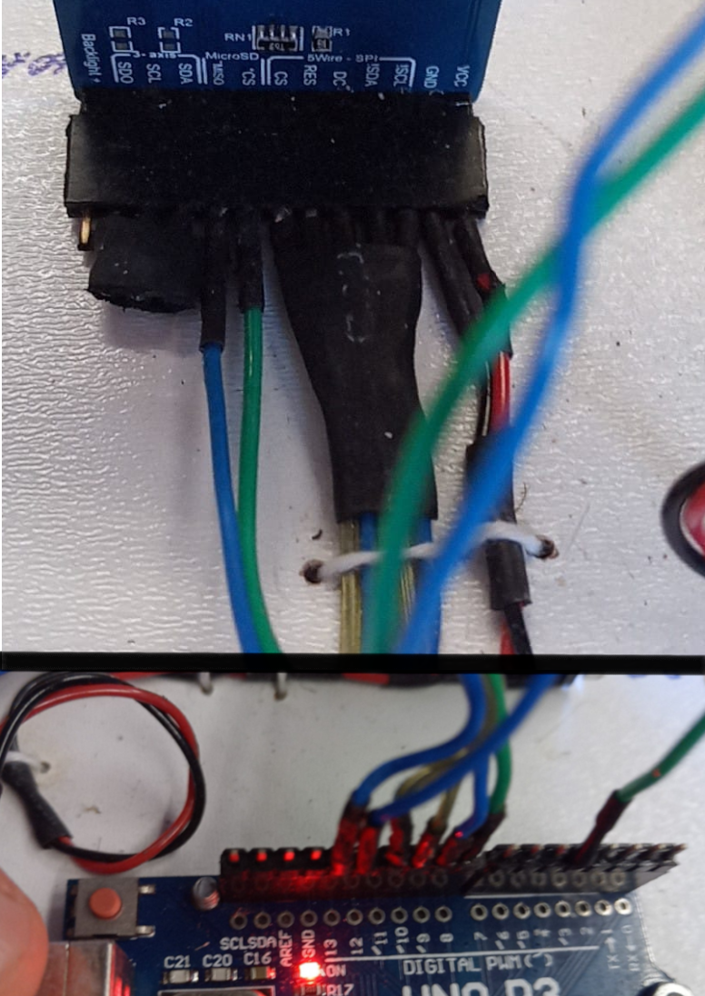

Step 1: ST7735 1.8" TFT LCD Wiring
The ST7735 1.8" TFT LCD module is connected to the Arduino Uno using SPI communication.
The VCC (or +) pin of the display is connected to 5V on the Arduino to provide power, and the GND pin is connected to GND.
The CS (Chip Select) pin is connected to digital pin 10,
the RESET (RST) pin to digital pin 9,
and the DC (Data/Command) pin to digital pin 8.
For SPI communication, the MOSI (SDA) pin is connected to digital pin 11,
and the SCK pin to digital pin 13.
The LED pin, which controls the backlight, can be connected directly to 5V or 3.3V, optionally through a current-limiting resistor. This setup allows the Arduino to control the display and render images from the SD card.
Step 2: SD Card Module Wiring
The SD card module communicates with the Arduino Uno using the SPI protocol.
The VCC pin of the module is connected to the 5V pin on the Arduino to provide power, and the GND pin is connected to GND.
For SPI communication, the MOSI pin is connected to digital pin 11,
the MISO pin to digital pin 12,
The CS (Chip Select) pin, which allows the Arduino to select and communicate with the SD card, is connected to digital pin 4.
This configuration enables the Arduino to read BMP image files stored on the SD card and display them on the TFT screen.
