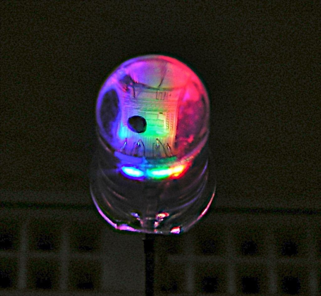

Step 8: The Rgb Led Lamp
The actual led lamp is the small part with the 4 legs. The long white extension is a kind of prism light diffuser.
It's a common anode led (shared positive pin)
Pinout from top to bottom (if you hold the led as in my picture):
Green, Red, Blue, common anode
