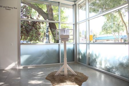

In terms of our bodies, we speak of "scanning" as quickly glancing at something from a lateral perspective, in which our eyes pan horizontally as our heads pivot on our spines. When we scan a text, our eyes move quickly from left to right. We may also scan the landscape from left to right. For this project I was interested in horizontality as it relates to scanning the landscape. The Western landscape was a veritable subject for legendary early landscape photographers. Early photographic processes were unwieldy, often requiring hauling large camera and even darkrooms into the expanses of the wild landscape. The desert with its bright sun light and solitude was idealized as a photographic site for Western expansion. Now we have new imaging technologies like the scanner. So, I created the Scannerscope, a camera made with a portable scanner and essentially a camera obscura or large-format camera.

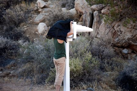

Your scanner is a handheld portable scanner that operates when moved across a piece of paper. There is a motion sensor on the unit and originally I thought that I was going to attach the sensor to a toy motor, but decided against it.
Step 4: Design

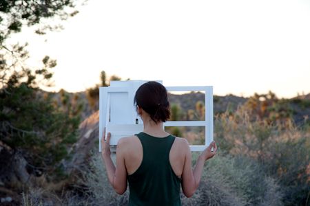

Once you figure out the focal length, then you can design the length. I designed this in AutoCad and then was able to bring the file to my studio on my ipad and toggle between the layers to see the different things as I was fabricating. The design work can be done in Illustrator or with simple pen drawings.
I made a rail system that the unit can slide across.
Step 5: Fabricate
Fabricate your ScannerScope. I used Styrene, a plastic used for architectural models and prototypes. Any sheet material—like, metal, wood, cardboard, foam core, plastic—can be used.
Step 6:
Test and experiment
This camera is rather unwieldy. In contrast to the smooth motion of your household scanner, this is done manually, with much distortion. The work becomes more performative. You'll need to use a light meter and test out with filters to get the exposure right.
