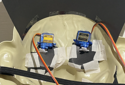

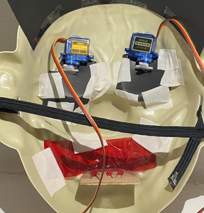

Step 5: Attach Servos to Mask Interior
Attach the servos to the interior of the mask with a small amount of silicone glue on the servo's case. The servo horn should be going through the eye's hole so that the eyes can be attached to them from the other side. Add black cardboard on the back of the eye holes with a hole for the horn to go through, so the servomotor can't be seen from the other side.

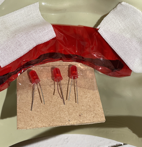

Step 6: Attach LEDS to Mask
Cut a small piece of cardboard for the LEDS to be placed. Cut a piece of red cellophane (10x10cm) on the mouth hole on the interior of the mask. Glue one side of the cardboard below the mouth hole on the interior and place the three LEDS with a piece of cello tape so they stay in place.

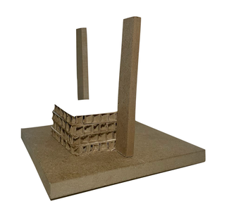

Step 7: Build the Base
For the mask to be held and the breadboard and Arduino to be placed, we are going to have to build a base with cardboard. Cut 4 pieces of cardboard (8x5x2cm) and glue them together, one on top of each other, and glue the to the center of the base cardboard (20x20x2cm). This is where the breadboard will be placed. On the sides of this cardboard glue two pieces of cardboard (15x3x2cm), this is where the mask will be placed with the help of an elastic band. It should look like the second picture.
