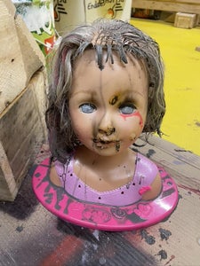

I got this doll from the recycling center, and made a few random changes: I burnt its face a little, and applied some paint. Not much effort is needed as it will not be visible very clearly inside the box.

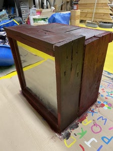

Step 2: Build the Box

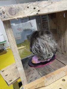

Apply the one-way mirror film on the glass, and use it as base for sizing your box. Verify that your doll fits inside.
Assemble planks together to form a box and make sure that the glass is tightened, and in the right direction (otherwise the one-way mirror won't work).
Behind the mirror at its base, add a piece of plank of the same length as the mirror. This will serve to hide the LED strip that will be positioned there.

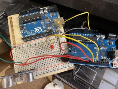

This is my prototype board. Notice that it used normal LEDs and not yet the LED strips. It therefore doesn't require an external power supply. This step is not mandatory if you know what you're doing, but it's always good to see the system work before you go further.

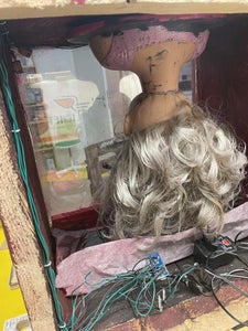

Step 5: Electronics Finalization

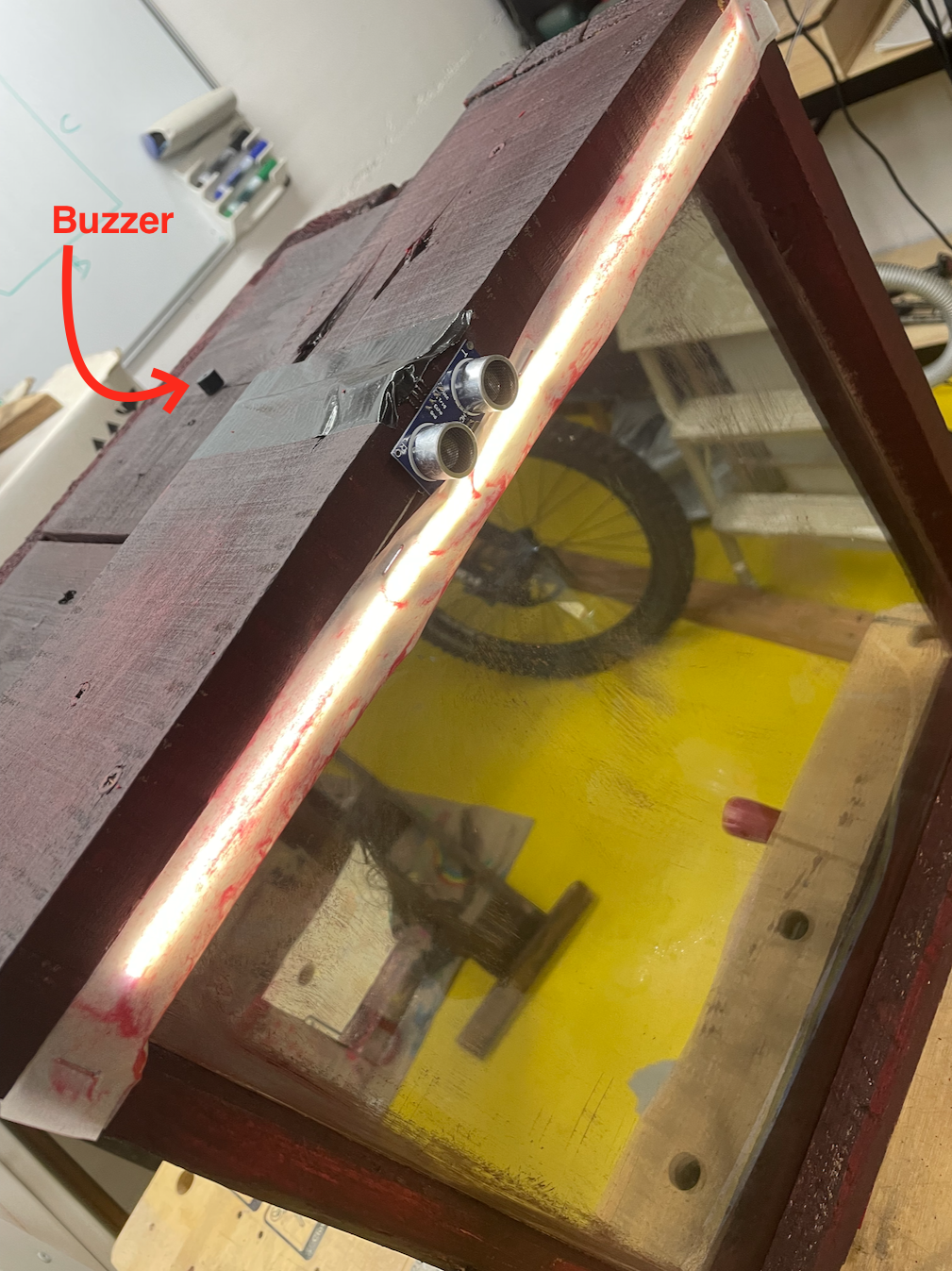

Place your components on the box:

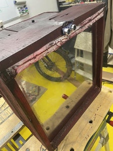

  1. 1 LED strip outside, above the mirror and facing horizontal
  2. 1 LED strip inside, behind the mirror at its base and facing up
  3. The distance sensor above the mirror
  4. The buzzer somewhere above the box

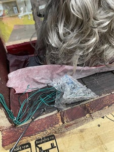

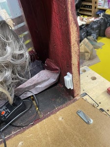

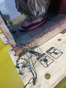

Once the components are placed, you can measure the length of your wires. Cut them to the right size and proceed with connections and soldering.

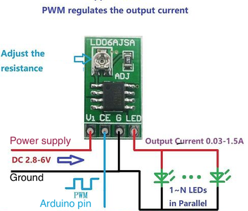

The final version of the circuit is the same as the prototype board, except I replaced the 2 LEDs and their resistor by 5V LED strips and an LED driver because the LED strips require more power than an Arduino board can handle. I also replaced the Arduino Uno by the Arduino nano. And it's now powered directly from a 5V power supply instead of the USB.
The power supply positive wire must:
  1. Be connected to the Arduino 5V pin
  2. Be connected to the LED drivers VCC pin without going through the Arduino
The power supply ground must be connected to the Arduino ground pin.

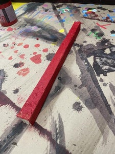

Step 6: Final Touches

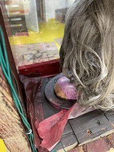

I stapled the parchment paper over the LED strip to make it more diffuse and resemble more a florescent light. Then I applied the remaining of black and red paint that was still on my brush in order to give it an "old and used" effect.
I also stapled the red plastic film over the LED strip inside the box.
Tidy all wires inside, secure the electronics in a small plastic bag.
If you like, place the doll upside down for a better surprise.
