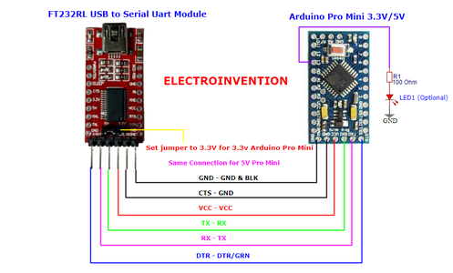

Step 1: Wiring
First, we need to connect the components as shown in the attached diagram.
Step 2: Program Arduino
Next, we need to program the Arduino Super Mini using a specific programmer. I’m using a UART-USB programmer from Amazon (code attached).
