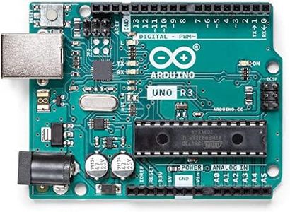

- 1 Arduino UNO board

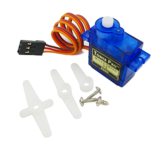

- 1 Servo motors (LINK)

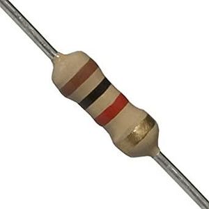

- 1 1K Ohm resistor

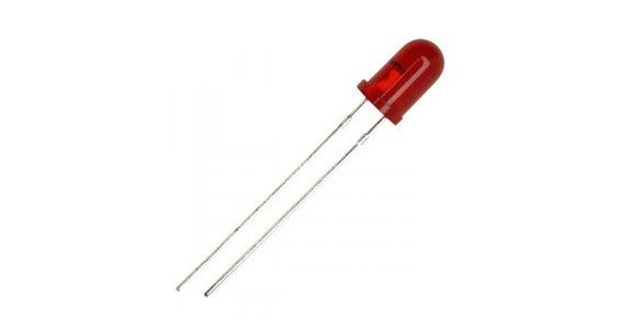

- 2 LED's

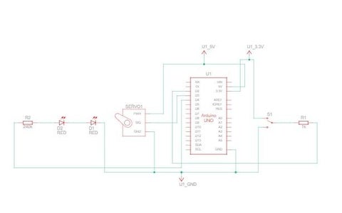

Step 1: Electrical Scheme
The electrical scheme is very clear and easy to understand. First, we will connect the servo to a power source (5V) and a ground. The last cable remaining being yellow, brown or white will be the signal one, connected to the pin number 3.
Once the servo is connected, we proceed with the switch and the LED's. To connect the switch we will run 3 cables from it, one to 3,3 v, another to ground and finally one for signal paired with the 1K ohm resistor to the pin number 2.
The LED's will be running in a series layout having the input voltage from pin number 4 and the connecting the last LED to the ground. This two LED's need to be soldered.
Finally, we will be running a connector to use a 9V battery to run the arduino inside the case and delete the cable. This will make the project portable and better looking.

- Inside the skull there are two LED's that need to be soldered in a series manner. From the anode running to the catode and then going to the anode of the next LED closing the loop. One end will be connected to positive and the other end to negative.
- A resistor of 1K ohm needs to be soldered to two pins in between the switch and the pin number 2.
