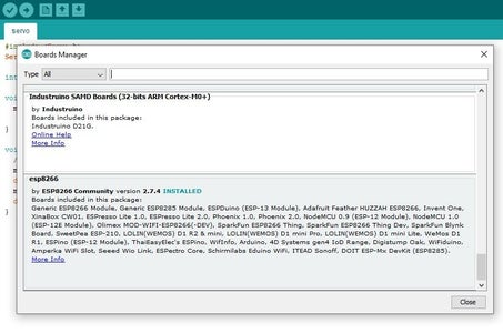

Step 3: How to Upload the Sketch to the ESP8266 Module
The steps to program the ESP8266 module using the ARDUINO IDE are the following:
STEP 1
Open the preferences window from the ARDUINO IDE. Go to File->Preferences and enter
"http://arduino.esp8266.com/stable/package_esp8266com_index.json"
into Additional Board Manager URLs field.
STEP 2
Go to Tools -> Board -> Boards Manager ...
Select the ESP8266 board menu and install “esp8266”
STEP 3
Choose Tools > Board > Generic ESP8266 Module.

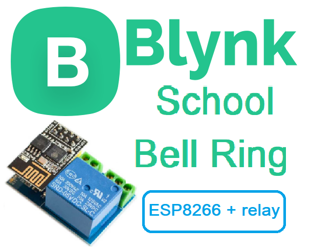

Step 4: The Device
The device is formed by a ESP-01 module and a relay everything integrated in a board. The ESP-01 module has two digitals I/O pins: IO0 and IO2 to activate the relay.
The board need 5V to work, as you can see in the image, so it need an 100-240 VAC to 5 VDC module
To control the ring bell, I have used the normally open (NO) pin of the relay
