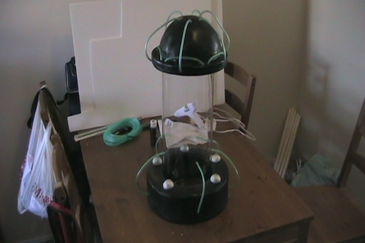

Introduction: Sci-Fi Cryo Containment Chamber
How to build a super cool, futuristic, sci-fi, cryo containment chamber.

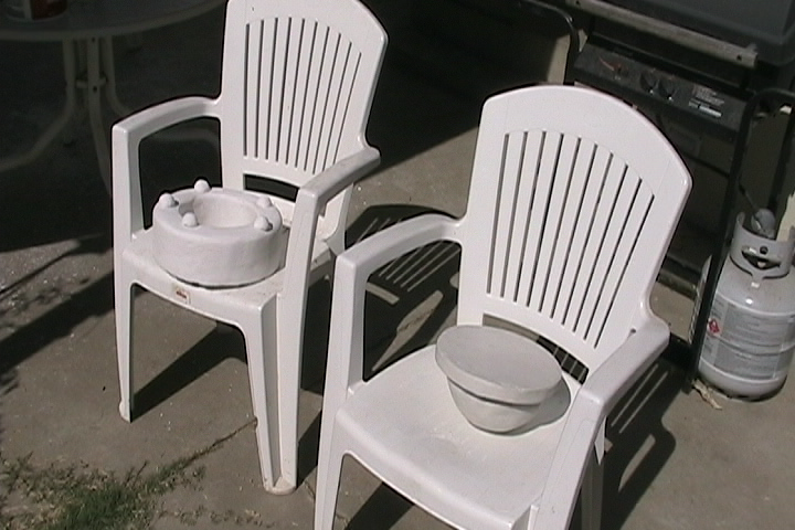

Step 2: Plaster
Now it's time for some plaster. When I mix my plaster I like to make it a little thick, that way it is easer to spread, kind of like butter. To fill in the large gaps I used a trowel but to fill in all the small holes in the Styrofoam I like to use my hands. So grab a pair of gloves and start spreading it all over the Styrofoam.
After each coat of plaster you want to do some sanding. It is best to sand when the plaster is hard but not entirely dry, that way you aren't breathing toxic plaster dust.
The best thing about this process is that if you make a mistake just put some more plaster on and sand it down.
For my prop I used about three coats of plaster.
After you are done let it dry.
