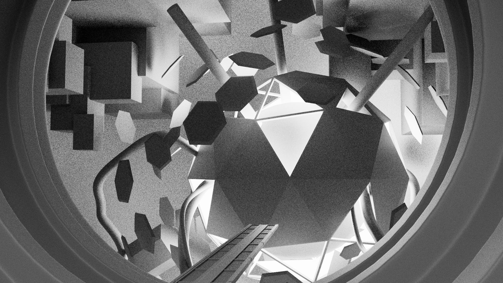

I made a scifi corridor from scratch, with a small alien robot floating around. I did this scene for a project in school, and I really love the concepts of the video game Control and SCP, so I referenced on their style in this project.
I did the 3d modeling with Autodesk Maya, and textured them in Substance Painter. At last, I used Unreal for lighting and rendering.

Step 9: Final Result
And here's the final result of this project! The experience of making this project encourages me to explore more in unreal, high poly baking, and trimsheets. Some details that I can refine is adding more particles in Unreal to make the scene a little more dynamic and try to add some nebula effect outside the window. Overall, I really love how this project turned out! Huge thanks to my friends who helped me through this process and the Autodesk Ambassador Program!
