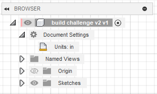

Step 1: Set the Dimensions
Set the dimensions of the project to be in inches in the browser on the top left.

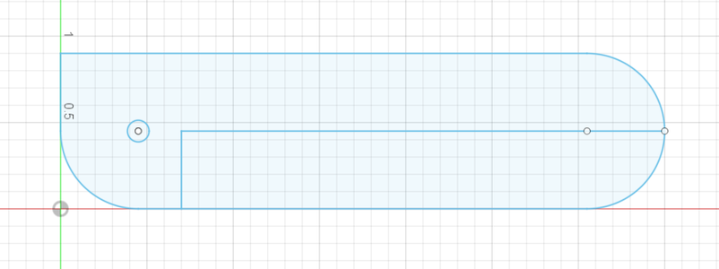

Step 2: Draw & Dimension the Blade
Roughly sketch this shape using two three-point arcs and lines to create the blade shape with a hole for a rivet. Then use the dimensions and constraints above to fully define the sketch.

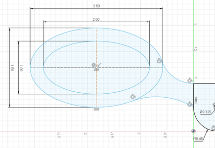

Step 3: Drawing the Handle
Because everyone has a different hand size, this is very customizable and you can create it according to your hand type. For this example however, we simply use two eclipses to create a handle and three-point arcs to connect it to the body. Some tangent constraints are needed to avoid unnecessary overlap.

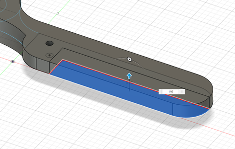

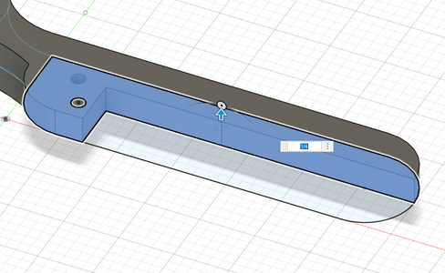

Step 4: Creating the Shape of the Blade
First extrude the handle part of the scissors symmetrically, then extrude the blade part, this is because we only want to fillet the blade side to make it sharp. Lastly, combine the bodies.

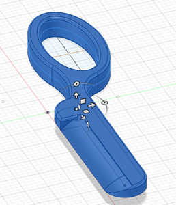

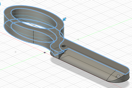

Step 5: Fillet the Edges
Select the faces above using the fillet tool to make the corners of the scissor smooth and feel better to use. Apply the value above. Now your scissor part is complete!
