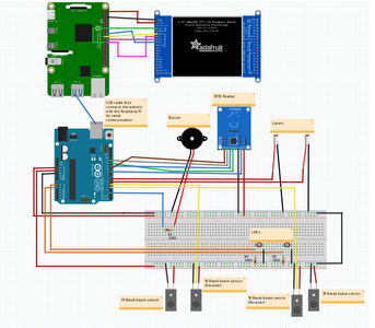

The first thing i did is building the circuit. As you can see in the picture i use both the 5V and 3.3V.
let's go through each component step by step:
- IR Break Beam sensors: All 4 of them are connected to the 5V and Ground pins, only the 2 receivers have an extra cable, and that extra cable we put in port 4 and 5 of the Arduino.
- RFID Reader:
- VCC is connected to 3.3V
- RST pin is connected to port 9
- GND pin is connected to the ground
- IRQ is connected to NOTHING
- MISO is connected to port 12
- MOSI is connected to port 11
- SCK is connected to port 13
- SS is connected to port 10
- 2 Lasers: The ground pins are connected to the ground, the VCC pins are connected to port 6 and 7 of the arduino
- Buzzer: the VCC pin is connected to port 2 of the Arduino with a resistor of 100 Ohm, the ground pin is connected to the ground
- 2 LDR's: one side of the LDR's is connected to the 5V with an 10K Ohm resistor. Between the resistors and the LDR's you have a cable that is connected to A0 and A1 to the arduino (to read the value of the LDR's).
- For the 3,5 inch screen: All the pins that are connected, are connected to the corresponding name on the Rpi.
At last we have the USB cable that connects the arduino and Raspberry Pi, we are going to use this to send data from the Arduino to the Pi. You can skip that part for now because we will need this USB cable first to upload our code to the Arduino via the computer.

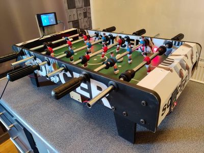

Step 2: Placing the Circuit in the Soccer Table

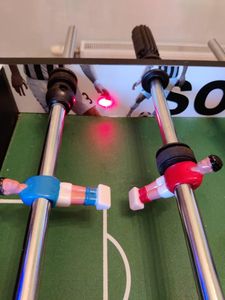

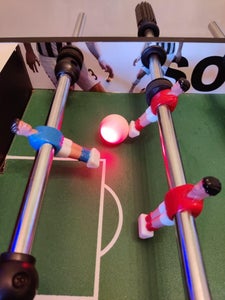

The placement of all the components is pretty specific. The IR Break Beam sensor must be placed inside the goals, make sure you place it where it does not obstruct the ball. I made 2 little holes right underneath each sender and receiver of the IR Break Beam sensors, that way the cables can not obstruct the ball.

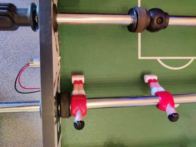

At one side of the table i made 2 bigger holes for the lasers, for the placement of the lasers there are 2 important things. The first one is to make sure you place it where it is not possible for the football players to interrupt the laser. The second one is to place it where the ball will always pass the laser if the attacker shoots the ball (that is between the attackers from the 1st player and the goalkeeper of the 2nd player).
The LDR's must be placed straight across the lasers (the laser must shine on the LDR). To do this perfectly you can put on the lasers and then make a hole in the middle of the light of the lasers.
I have put the RFID on the front of the table, but the placement of that component doesn't matter

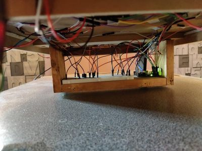

On the back of the table I fixed a shelf so the raspberry pi can hang on 2 screws to display the score, I recommend to put heat shrink tubing on the 2 screws where the Pi is hanging on
In the middle under the table I made a little table with 3 planks where the Arduino and the breadboard lies on top, that way it is always easy to fix something if something gets broken.
The USB cable needs to connect the Arduino with the Raspberry Pi, i made a hole underneath and on top op the table cause my cable was to short, it is possible to just connect the Arduino with the Pi without making any more holes in the table.

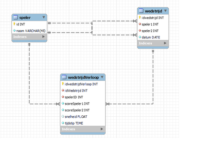

I'm going to start with the backend code. First we have the Database.py, with this file we connect with our database and we are able to do the CRUD actions (Create, Read, Update, Delete).
Datarepository.py is for all the sql statements we need to get our data that we are displaying on the website (all the players, the played matches,..). Here we use the class Database that we made in Database.py.
Then we got the App.py, here we create our application with Flask and socketio. It is also the place where we read and send information from and to the Arduino, this happens in a thread. All the app.route() functions is for getting the information out of our database with the help of the class Datarepository (from Datarepository.py). They will ask the information and send it to the frontend in a json format.
Socketio is a bit the same as app.route but with socketio we can send realtime information to the frontend. It means that you don't need to refresh the page to get the new values. The main use of this is to get the current score of the match.

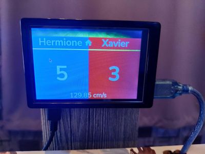

If evrything is done the site for playing matches should automatically display on your RasPi screen. The IP-address at the bottom of the home page is the address you need to type to go to the site via your computer/cellphone (this only works if you are on the same WiFi network). The site will be bigger on your computer and cellphone. The screen on the Pi is only for displaying the score of the current match. Anywhere else you can add and delete players, look at matches and delete them and watch all the matches played between 2 specific players.
Enjoy!
