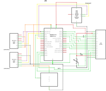

Step 1: Electronics & Circuit Setup
Before starting the actual build, it's important to make a prototype and have a clear reference for how everything should be connected.
To help with that, I created a Fritzing diagram that shows how to wire all the components. This made it much easier to follow while building the circuit — and most importantly, it helped me avoid damaging my Raspberry Pi.

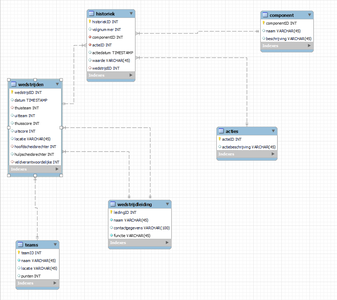

Step 2: Database Design
Next up, the database. We need to make sure the data can be stored in a good way and that our database is easy to expand without changing our whole logic behind it. That's why I made sure my database is 3NF, this means it is expandable if u would like to add things to it.
Database Tables:
acties: This table stores the actions of what a component did
component: stores all the components u have and describes what they are
historiek: : Here you can see what the components did and when they did it, this is really handy if you want to make a graph of your data for example.
Teams: Store all the teams there name location and points
wedstrijden: The games that are played are stored here which team against which, the score, location, and referees.
wedstrijdleiding: all the referees and there role
You can see the EER Diagram above and how I linked everything together.
You can just run the .sql file in your workbench and everything should be setup with dummy data.
