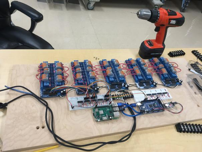

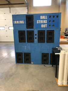

Step 1: Assembly of Logic Board
To begin assembly, a scoreboard is required. This scoreboard was produced by a local company named Daktronics, and was manufactured in the early 1980’s. It is made entirely of aluminium and was pending recycling before we acquired it. It was saved, stripped down to a shell for cleaning, bulb replacement, a quick paint job and new decals. Boards of this vintage were built in either 13 (5 x 3) or 20 (7 x 4) bulb configurations. The wiring behind them is very straightforward, utilizing only 9 wires to control all the bulbs. Our board utilizes the larger 20 bulb configuration but with lower power 11 watt incandescent bulbs. Any number can be displayed by powering the correct combination of bulbs.
The external control panel accompanying the original logic board was lost, and the latter did not provide the functionality we desired, so it was removed. Ensure that the logic board is smaller than the available space, leaving approximately 1 to 2 inches around the board for cable management. Leave plenty of space on each end of the board for power cables and distribution blocks. We tested the approximate size and placement of each component using extra devices as temporary standins before wiring began.
Measure and trace the relay boards as they will take up the bulk of the available space, and leave roughly equal amounts of space between each for attaching the cables. Measure and space your neutral and 120V distribution blocks appropriately.
On the other side or the board, measure where you will place your Arduino and Raspberry Pi. An RTC module should also be placed nearby, to be used as a timekeeper when the board is powered off. Additionally, depending on the power supply configuration, a voltage step down may be required to provide appropriate voltage to some components. A +12VDC central distribution block is used to power the relay boards, which in turn provide +5VDC power to the breadboards.

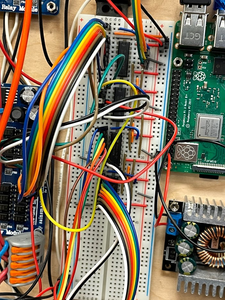

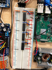

Step 2: Breadboard Layout and Wiring
As seen in the photos, there are a lot of wires used to power and control the logic board. To start, we’ll go over the layout of the breadboards. Each breadboard has a few 74HC595 shift registers chained together to simplify the process of programming and addressing each 7 segment digit. Every shift register acts as a single “digit”, which is then outputted in binary form to each segment controlled by the relay boards. As an example, to display the digit “8”, a single shift register would output 11111111. The arduino uses 3 wires to control the shift registers, a data pin, a latch pin, and a clock pin.
