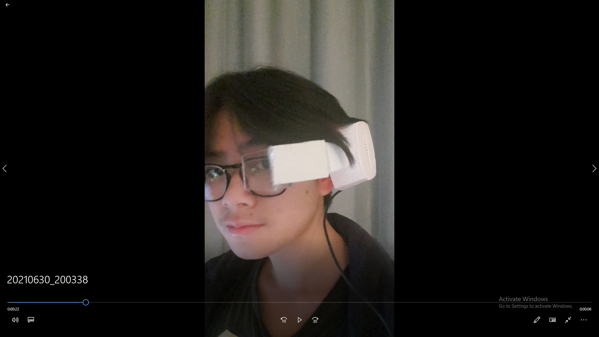

I started out on this project because I was watching Dragonball Z and I saw the scouter and thought how it would be so cool to build something similar. I also play a decent amount of Overwatch and I mainly play Baptiste. Baptise has a screen near his eye which is similar to the DBZ Scouter. This kind of device that lets you integrate modern day technology into the real world, which is really cool. This project works by displaying an image on a 128 x 64 screen and is reflected by a mirror then focused by a fresnel lens and then displayed onto a piece of acrylic. I used an Arduino Nano as the brains and a 9v battery at the VIN and GND pins to power the entire thing. The way it attaches to my face is with a small clip and I slot my glasses onto it. Don't worry if you don't have glasses. You can always attach a headband to it or use some old glasses and remove the lens similar to that of Zack Freedman's Optigon
Everything here is 3d printed but you can always use something like cardboard as I did in my first version. Cardboard works better than you may think.
