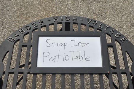

Introduction: Scrap-Iron Patio Table

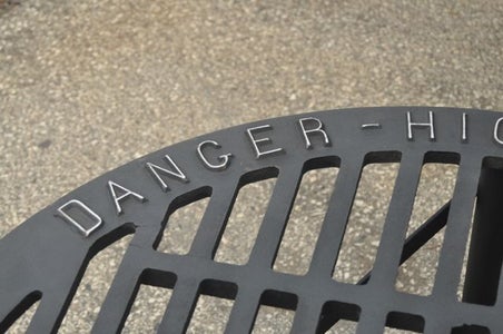

A couple of years ago, I found a fantastic piece of scrap iron at the salvage yard - an access grate, something like a manhole cover or storm sewer cover. It's about 36-inches across, and best of all, says "DANGER HIGH VOLTAGE" on it!
The "High-Voltage" lettering struck a chord with me, as I've been on a bit of a journey of self-discovery these last few years, working on electric vehicle and related projects.
This Instructable will take you step by step through how to make a patio or lawn furniture table, completely from scrap iron. I wanted to name this project something like HIGH VOLTAGE TABLE, but with projects I've worked on before, people might assume that the table was somehow battery-powered or featured an electric motor!
Nope, this is just a table, but it was made completely from scrap metal, and I'm pretty proud of how it turned out.

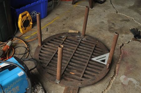

Step 2: Making the Legs
Since I already had a large single piece of scrap iron that was essentially the entire top, I started the project by working on the legs.
I wanted the table to be a low height for use while seated - what you might think of as "coffee table height". What else is nice about that height is it can double as a foot-rest or additional seating. So, I measured my ottoman and a few chairs, and decided that 18" tall would be about right for the table.
Cutting:
I cut four pieces of 1.5" diameter steel tubing to 18" long. This was all recycled scrap tubing that I have on-hand for projects, purchased by the pound from a junkyard.
I measured each piece to 18" long, marked all the way around the tube, and then cut it with a cut-off disc in the angle-grinder. A speed-square is handy for marking all the way around and ensuring that the cut is at 90 degrees. If you have a metal-cutting chop-saw, that makes it easy to ensure your cuts are square.
Bolt-On Leg Feature:
Welding to cast iron isn't easy. And I'm no master welder, either... I've also decided that any time a person CAN make something collapsable, foldable, or easy to disassemble, one should. If nothing else, it makes it easier the next time you have to move or even carry the item through a doorway.
With this in mind, I decided to make the legs removable from the table top. The grate already had two points that were originally used to bolt it in place. I would re-use those as points to mount the legs to. Because of that, only TWO of the legs would need a bolt on them.
So, I took a piece of scrap iron, about 2 inches wide and 5 inches long, and prepared it to become the mounting points for the legs.
To start with, I drilled two 3/8" holes through the metal.
Next, I set a 3/8" nut on top, and then ran a 3/8" nut and bolt into it from the other side of the scrap metal plate. That would hold the nut in place, and keep it from moving.
I then welded the nut in place, and repeated with the other hole.
After that, I set on of the legs centered over the nut, so that the nut was INSIDE the leg, and welded the leg in place. Then I did the same with the second leg.
Once BOTH legs were welded to the plate (with nuts hidden inside) I then used the angle-grinder to cut the plate in half and separate the two legs. The reason why I did this, instead of building the two legs independent of each other is that sometimes materials are TOO SMALL to handle easily. For example, on a small plate of steel, there may not be much room for the ground clamp of the welder. Other times, it's hard to clamp a workpiece in a vise. Working on both legs together, and then cutting them apart at the end made it much easier to work with and weld.
Once I had two legs with end-caps and hidden nuts welded inside them, I could run the 3/8" bolts through washers, through the grate, and tighten them into the legs.
At that point, I could balance the table on the two bolted-on legs, and prop it up with the two unattached legs.

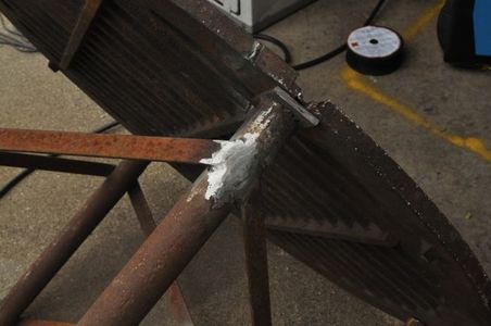

Step 3: Cross-Bracing
Not only do the legs all have to be connected to each other, but they also need "cross-bracing" to give strength against folding and twisting.
To do so, I would make an iron "X" connecting from the top to the bottom of each pair of legs.
I decided that I would like the cross-bracing to meet the about 3 inches from the top and bottom of each of the legs, so I put a 3-inch-mark at the top and bottom of each leg.
I then set the legs on the top of the upside-down table, and measured from the upper mark on one leg, to the lower mark on the other. That distance was roughly 27 inches.
CUT
So, I then cut eight pieces of my 1" wide iron flat stock to that length, but with an angle on the end, instead of square to match the angle they would go.
I used the flapper disc on the angle-grinder to brush off the area on the pipe where the ends of the cross-bracing would go.
WELD
With the two bolt-on legs in place and tightened down, I tack-welded the cross-bracing to the weld-on leg, up to the next leg over. I then made sure the leg was square in both directions (using the speed square) before tack-welding the cross-bracing to the "loose-leg", the one NOT bolted to the grate.
I did this on both sides, so the cross bracing went from low on the bolt-on leg to high on the loose leg, to low on the other bolt-on leg, to high on the second loose leg, and back to low on the first bolt-on leg. In this way, The TOPS of both the loose legs were squared up and held vertical.
After that, I welded cross-bracing from the tops of the bolt-on legs to the bottom of the loose legs, making sure the legs were square.
After everything was together and square, I went back and made solid, full welds at all points.
I also brushed the rust off at the mid-points of the cross-bracing, and then welded there.
