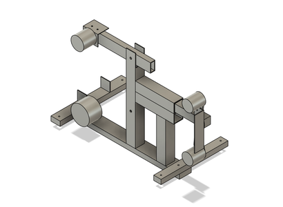

After disassembly and rough cleaning I was able to assess the pieces that I had collected and begin to draw up a simple design in Fusion360.
Step 2: Designing in Fusion360
When I had sorted through and picked out pieces that looked good for this project I sat down and threw together a rough sketch of the design. The most important part in this process was to fit the wheels so that it could run a standard size sanding belt. I didn't want to have to make my own belts and therefore it was important to decide measurements for the individual parts so that it would all fit together nicely. The process also allowed me to design the wheels themselves as I was planning on 3D-printing them.
To be able to have an digital design behind you as you work on the parts is a nice backup for double checking measurements and fittings as well as to avoid making parts multiple times as the result of mess ups.

First let's focus on the frame of the belt grinder. This part was assembled with parts of square tubing from the exercise bench which was cut using the angle grinder, sanded and welded together to form the body. I spent a while cleaning the pieces from rust and old paint using the wire brush to make sure that it would hold up when the motor was turning. The adjustable pieces are used to make the slot for the platen attachment later on and use plastic rails inside the steel tube to ensure a snug fit between the parts.
From the treadmill I was also able to extract some square steel tubing that would serve as the base of the grinder. The most important part is the motor mount that was scavenged from the treadmill. Using the mount it would be easier to attach the motor in a way that minimized eventual vibrations compared to trying to make a mount from scratch. Using the drill press I was also able to drill the holes that would allow the parts to be bolted together.
Step 4: Building the Tracking System
Next part of the project was to work out a system to be able to track the sanding belt. The tracking part is made on a horizontal arm connected through a slot in the top of the frame tower. The tracking requires two components, vertical adjustment and horizontal adjustment.
The vertical adjustment regards tracking the belt side to side to make sure it doesn't wander of the wheels. This is achieved using a hinge with a bolt through it as the attachment point for the wheel, and then running another bolt through the tube from behind to push against the back of the hinge. By welding a nut onto the tube we can screw the bolt in to lift the hinge, moving the belt inward. Screwing the bolt the other direction results in the belt moving out from the arm.
The horizontal adjustment regards keeping the belt under tension while it is running. We achieve this through a system of two bolts and a firm spring. One of the bolt is screwed through the tracking arm and the other is anchored in the frame. The spring pulls down the one side of the arm, pulling the other side up. The side that is pushed upwards is where the wheel is attached therefore putting tension on the belt. As a nice side effect of this system it is easy to change belts just by pushing down on the tracking arm to release the belt.

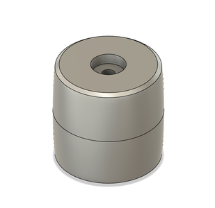

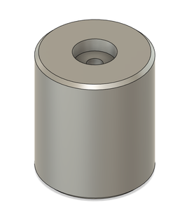

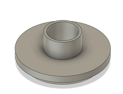

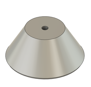

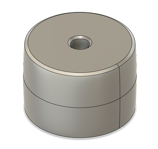

For the wheels I used Autodesk Fusion360 and a 3D-printer to design and manufacture the drive, tracking and platen wheels. The drive and tracking wheels are a bit crowned on the outside to better track the belt. By making a slightly cone shaped hole for the ball bearing I was able to press fit them into the wheels. Throughout multiple of the steps I've used the 3D-printer to create bushings for a tighter and more snug fit between the parts. Primarily in the platen attachment and to make sure the tracking arm doesn't tilt to the side where it is fastened on the frame tower. The printer has been very useful in this regard, allowing multiple iterations of the same part to be tested. The feet for the machine were also 3D-printed and fitted to the frame with bolts.
