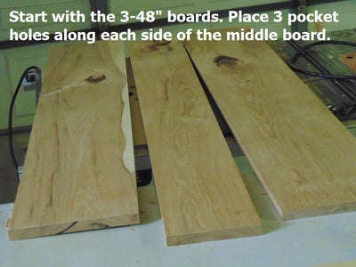

Table :

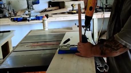

Start by drilling the pocket holes along both sides of the 6 1/4 inch wide board.
then use pocket hole screws and glue to attach the 2 - 8 3/4 inch board to each side. this makes your top.

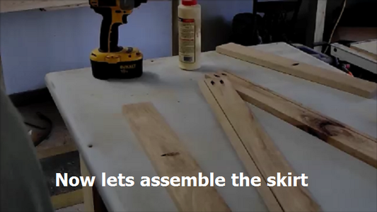

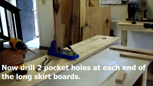

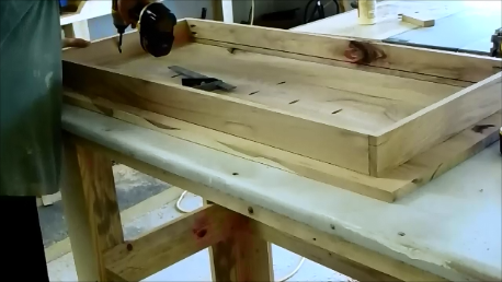

Step 3: Step 3 : the Skirts
Table :
Start by drilling pocket holes into the 2 longer skirt pieces. (2 3/4 x 42 3/4 x 34)
then glue and screw them to the shorter skirt pieces. (2 3/4 x 20 x 3/4)
Stool :

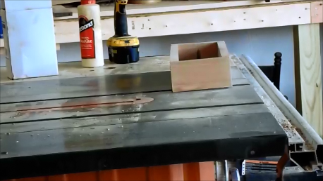

Start by drilling pocket holes into the 2 longer skirt pieces. (2 3/4 x 5 1/2 x 3/4)
then glue and screw them to the shorter skirt pieces. (2 3/4 x 13 3/4 x 3/4)

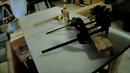

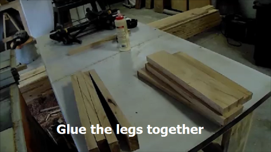

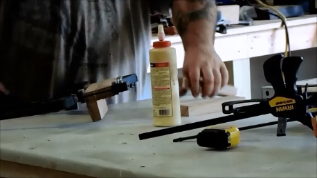

Step 4: Step 4 : Glue Up the Legs
Table AND stool :

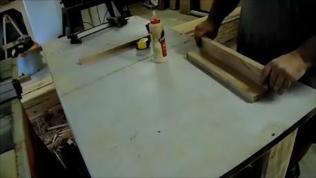

Glue the skinny leg boards to one side of the wider legs. clamp securely. no need to use nails or screws here. Just glue. clamp, and let dry :)

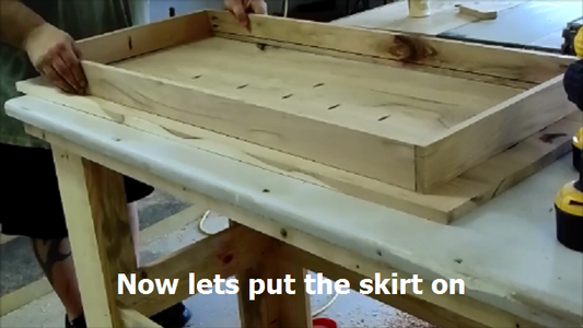

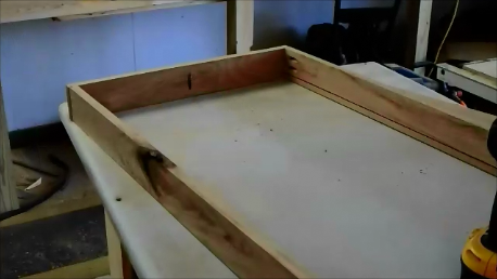

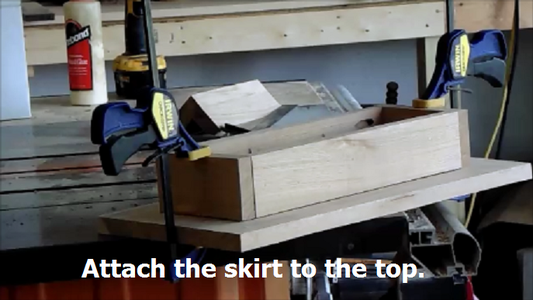

Step 5: Step 5 : Attach the Skirts
Table AND stool :

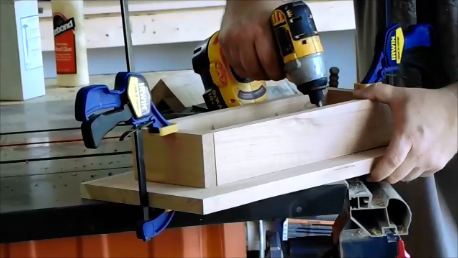

Again, The procedure here is the same for both the stool AND the table. Using pocket holes and pocket hole screws, Simply attach the skirt to the top. real simple. Glue it and screw it, and let it dry.

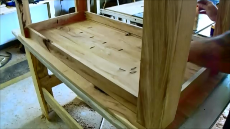

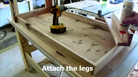

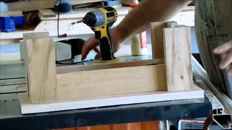

Step 6: Step 6 : Put the Legs on Them

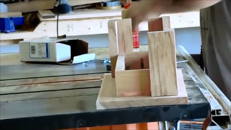

Table AND stool :
Again, same procedure for both the table and stool. glue the legs, and attach them to the skirt, using pocket hole screws through the skirt into the legs. no pocket holes required, but the screws work great!!

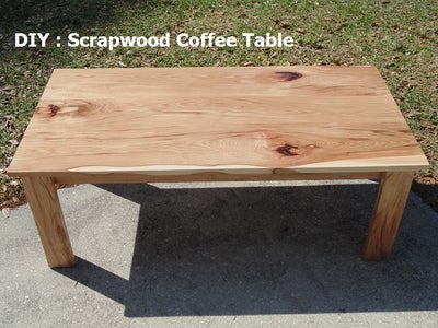

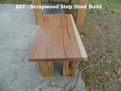

Step 7: Step 7 : Enjoy Your Work
You are almost done. Apply the finish of your choice, And enjoy them for years to come! I hope you enjoyed this Instructable, And until next time, Enjoy!!
