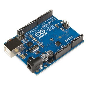

  1. Arduino UNO R3 (or any copy, that's fine too, as long as it works the same...)

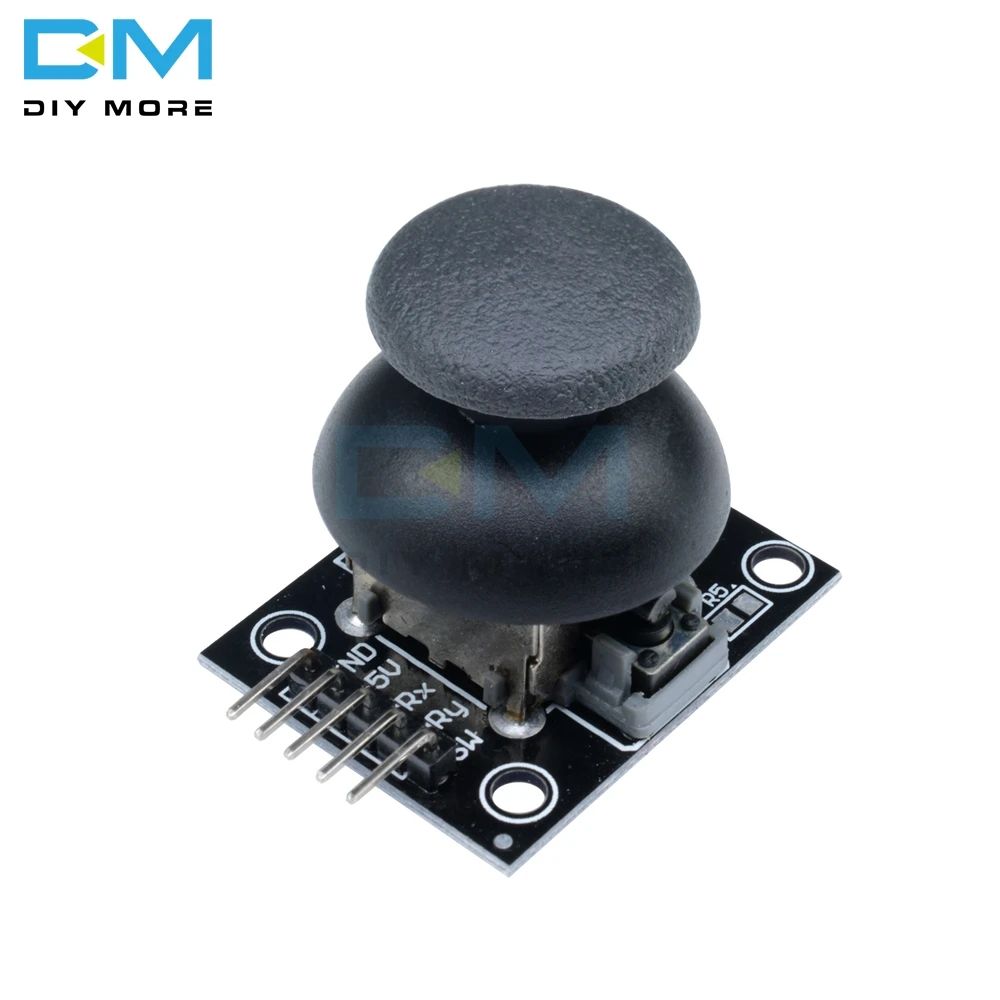

  2. Joysticks (youll need two of these, check the image, it's gotta have 5 pins.)

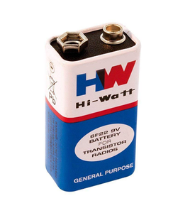

  5. A power source (anything to power your arduino with:9V battery, Battery Pack, Battery case you ripped out of your toy RC car, or even your laptop charger or arduino cable.)

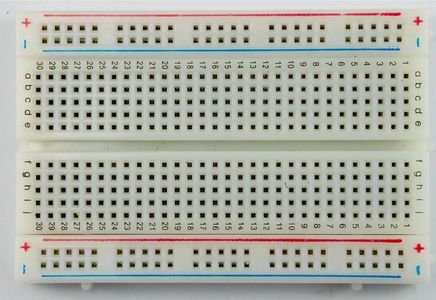

  6. Beadboard (Any type that has the power row.)(the row with the plus and minus on either side.)

  1. Arduino UNO R3 (another one...)

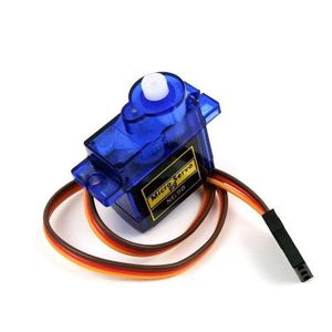

  2. Servos (atleast two, any kind you can grab)

Joysticks to Arduino UNO:
(the joystick's got 5 pins, both the joysticks have a similar wiring process.)
First Joystick:
GND----------Negative row of Beadboard
5V----------Positive row of Beadboard
VRX----------A0 of Arduino
VRY----------A1 of Arduino
SW----------D0 of Arduino or any digital pin
Second Joystick:
VRX----------A2 of Arduino
VRY----------A3 of Arduino
SW----------D1 of Arduino or any digital pin

Any Battery type Power supply can be connected to the Positive row and the Negative row of the Beadboard,
If your power supply is the Arduino Cable or a Laptop charger, (yes, I was serious), then connect it to the Arduino, and connect the 5V of the Arduino to the Postive row and the GND of the Arduino to the Negative row on the Beadboard.
(Arduino Uno's Vin should be connected to the Positive row of the Beadboard and GND to the Negative
so that it's powered.)

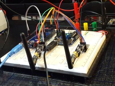

NRF to Arduino UNO:
CE----------D9 of Arduino or any free Digital Pin
CSN----------D10 of Arduino or any free Digital Pin
MOSI----------D11 of Arduino or any free Digital Pin
MISO----------D12 of Arduino or any free Digital Pin
SCK----------D13 of Arduino or any free Digital Pin
VCC----------3.3v of Arduino (DO NOT Supply 5V from beadboard)
GND----------GND pin of Arduino
IRQ----------Leave it Unconnected

NRF to Arduino UNO:
Servos to Arduino UNO:
You'll have to split the 5V into many parts, you can use anything that is light enough and lets you split your power for this. In my case, I used a couple of resistors. (see image)
First Servo:
GND (the darkest wire)----------GND of Arduino
5V----------Power source
Signal (the brightest wire)----------D0 or any dightal pin of the Arduino
Second Servo:
Signal (the brightest wire)----------D1 or any dightal pin of the Arduino
Connect your battery to the Arduino in any way you can, In this case a battery holder is used (see linked file)
The best way is using a 9V battery connected with a capacitor (see image)

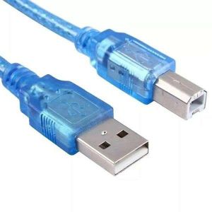

Note: You will have to download Arduino IDE (Arduino Environment) in order to input your codes. You have to connect the Arduino board to the computer you are using via the connection cable. There are many online resources to help you with this step.
